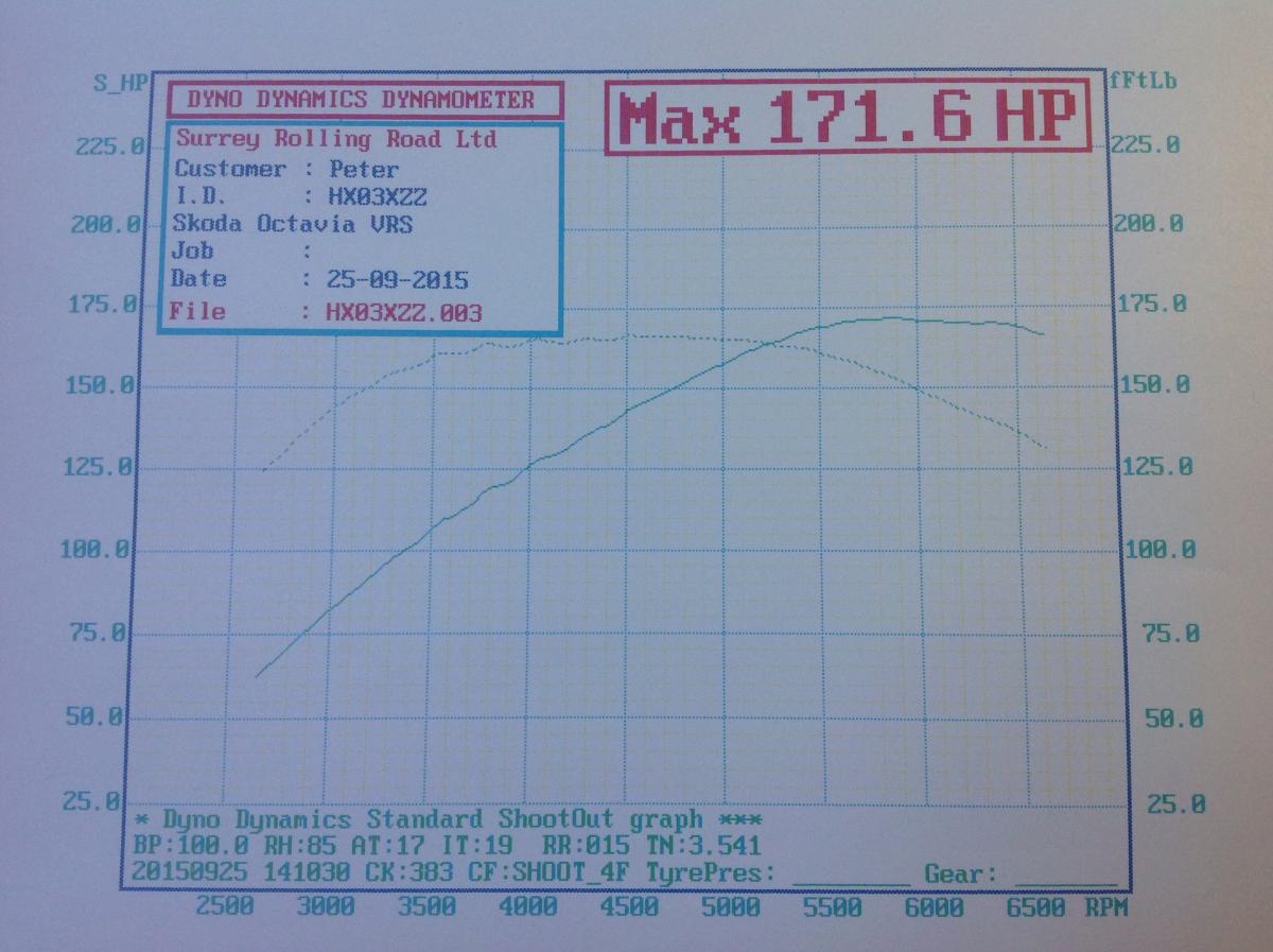

Seems I lost a little BHP
Bought a high milage Mk1 last week that is in very good condition, goes well and I am very pleased with it.
I thought I'd put it on the rollers and see what power it gives.
Sorry about the sideway piccy!

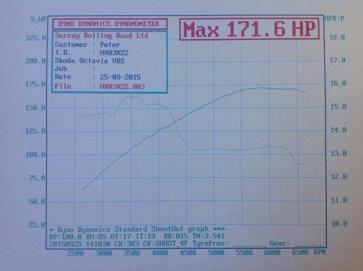

Second and third run were similar but dropped to 150ish BHP.
Tester thought that it was running a little lean so the ECU backed off. Maybe in need of a new AFR?
Any thoughts from you hardened experts?

171.6 on the graphs, expected for an older high mileage car, standard that is. Further drop to 150 and ecu retardation could be down to heat soak, depends on the circumstances. Hard to tell wwithout intake temps, maf and boost being logged but I don't think you've much to worry about if standard. A terraclean would reclaim some horses, mixed reports on the benefits but reclaimed bhp and mpg, and reduced emissions are the positives.
The important thing there is that the line is pretty smooth and not fluttery.

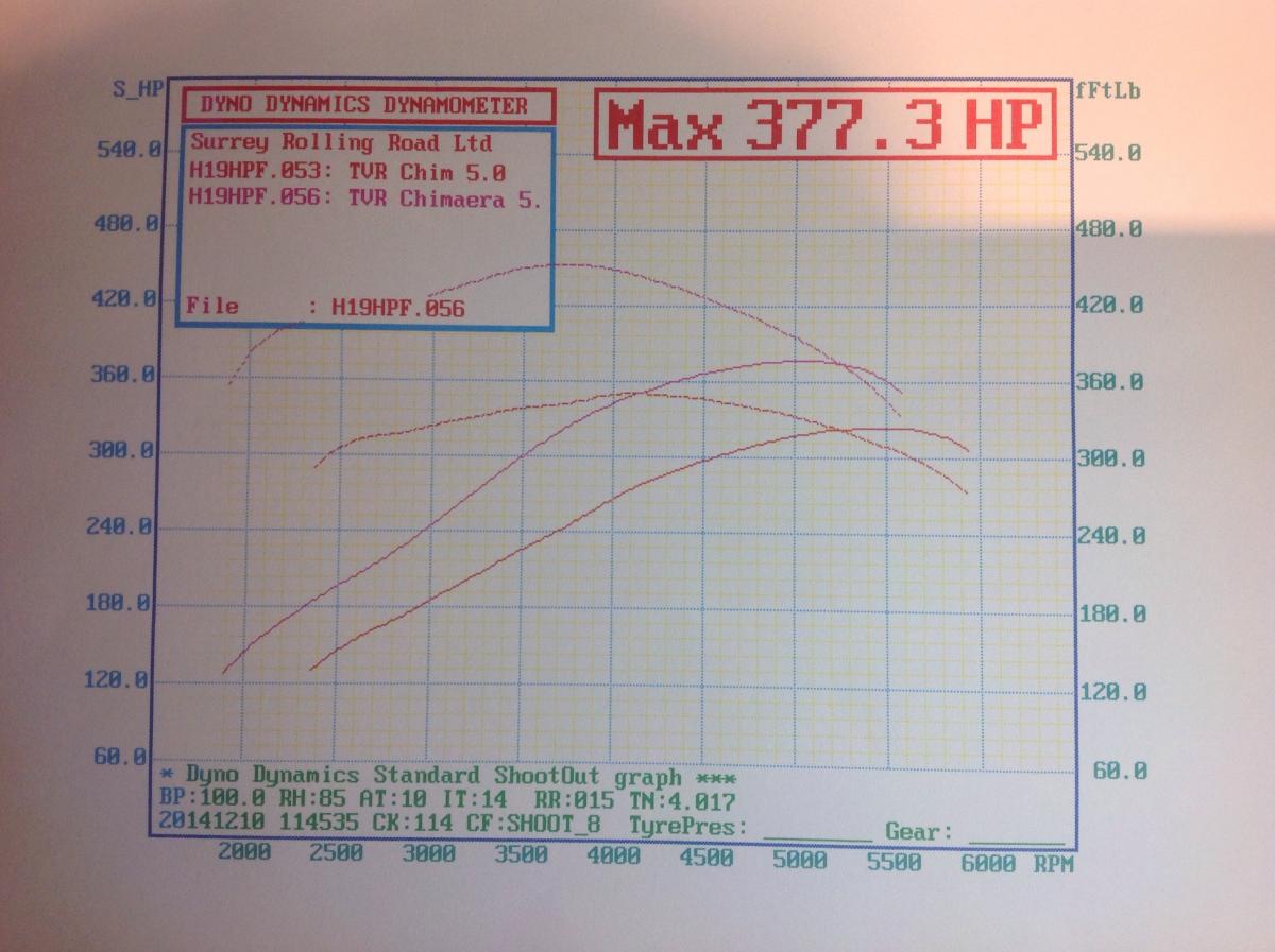

Out of interest, you may wanna see the graph of my other car at the same place.

Ah a good old Trevor, nice mate, very nice.
Like I said though if the vrs is standard I don't think there is much of an issue. The heat soak would get bad with multiple runs. The ecu retards timing from 36 degrees ( I think, around that anyway). With the standard smic in those conditions (cooling fan probably missed the key area as well, and without a vent in the arch liner?) those temps would probably be reached and could result in a significant loss.

I will get it mapped next week but I suppose logic dictates that if the first run was ok then all was well at the time.
The second and third runs were straight after so my worry was that something was failing?
Not experienced in these modern fandangled cars, RV8s are simpler!
If they were straight after I'd say heat soak was the issue. The smic isn't the biggest and on rollers they don't get real life airflow. Fitting a vent in the arch liner like a TT has does help, there's a thread for a how to on here somewhere. Try Google search octavia arch vent mod.
