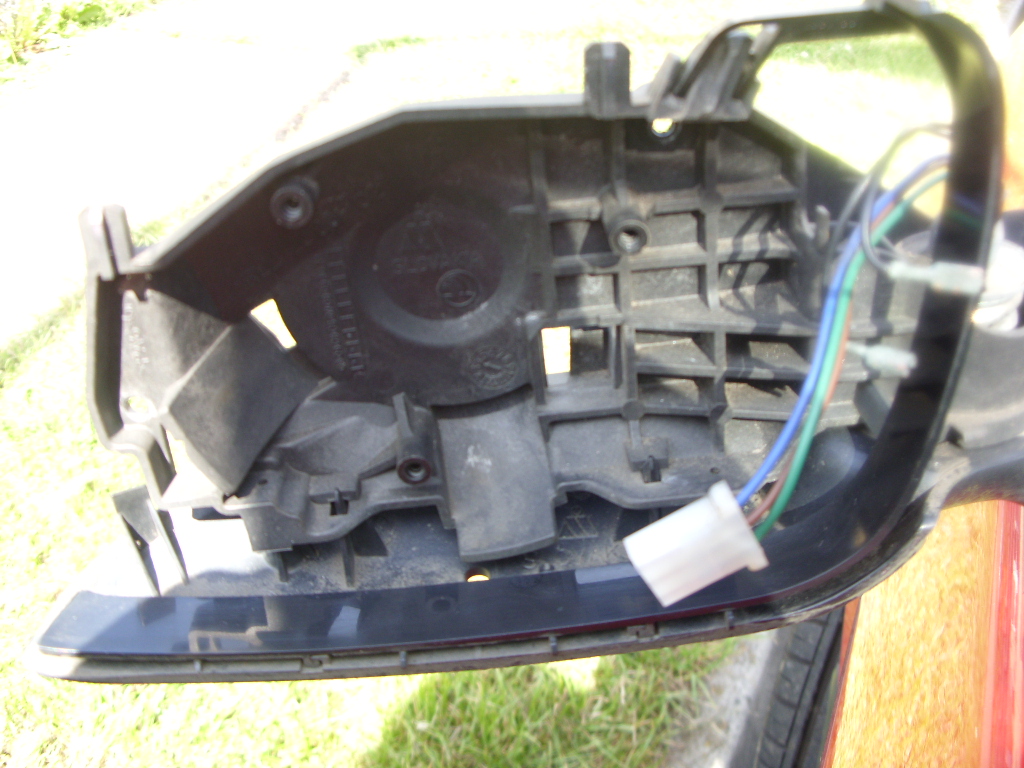

Wing mirrors need a paint
Any tips on removing the covers, google doesnt provide much other than everyone seems to break their mirrors :p
Pull the glass off and that will reveal two (I think) fixing screws.
Whats a good technique tool for pulling off?
Use the motor to tilt the glass in (or out) and then just get your fingers behind and pull.
The glass is attached to a spherical bit of plastic inside the mirror housing by three or four curved spring clips.
cheers appreciated

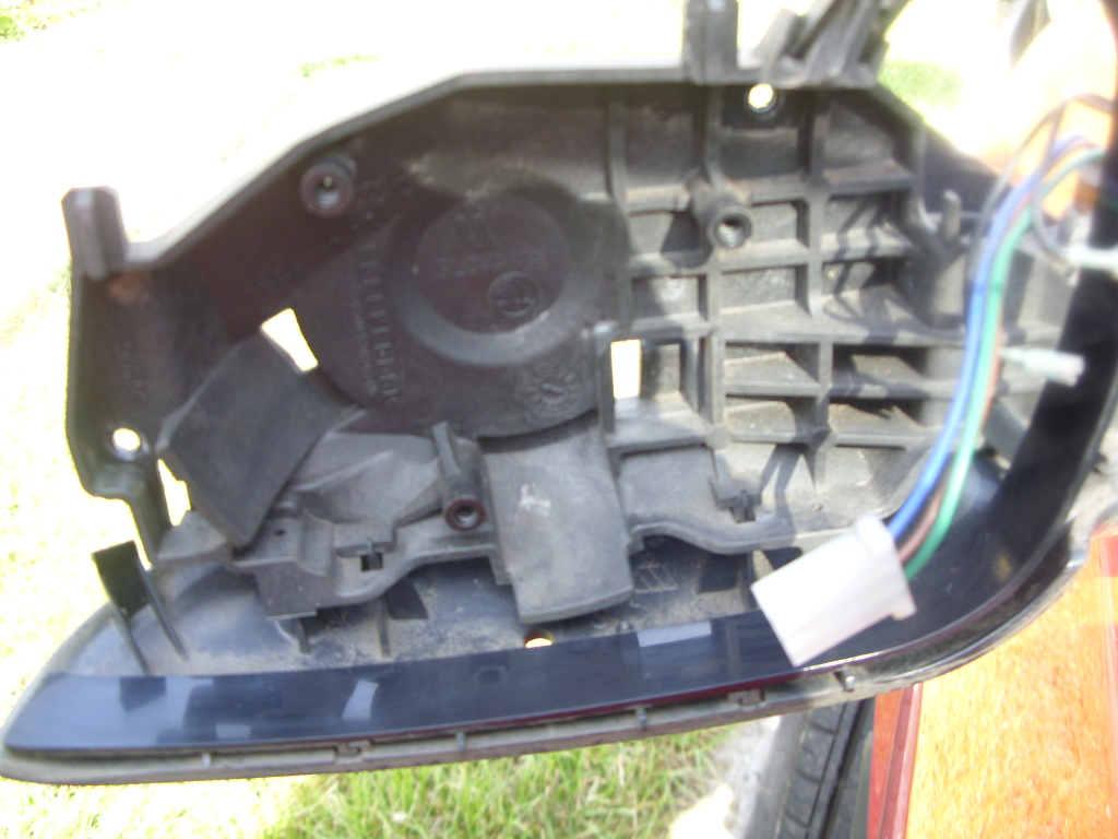

Ive got them off, how ever the passanger side on pulling out, pulled all the back out and the pins that i take are responsible for the movement. Ive pushed them back in but maybe knackared ... Im guessing was due to the rust in there!!

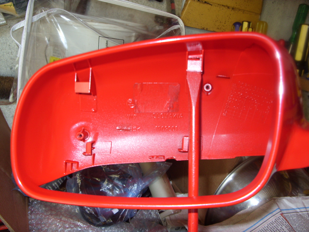

Avoid touching surface with your fingers before finishing cleaning with tac cloth, do (as I illustrated) stick long handle screwdriver into cover slot.
I then placed screwdriver handle in a bench vice, to get access all round cover to finish cleaning, getting rid of finger marks (grease) and to spray paint etc..

I just rubbed down using 2000 grit and got rid of the layer of lacquer, used tac cloth afterwards.
Used light coats (2) of red primer..(as mirror covers are Corrida Red).
Then sprayed with colour till primer well covered, then sprayed with clear lacquer.
