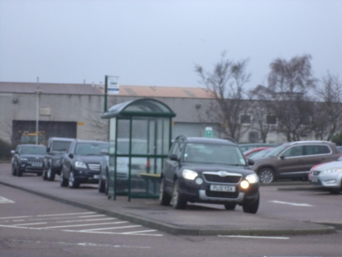

When the driving lights are on, everything seems fine with the front two driving lights illuminated.  When on full beam everything is fine too with both headlights and both front driving lights illuminated.  But when on dipped beam headlights, the nearside driving light goes out leaving the two headlights but only the  offside driving light illuminated.
Is this the way it should work or is there a fault?.  If the latter I'd like to get it attended to before the warranty runs out later in the year.

If you mean that one of the lower portion of those lights is illuminated then, as you have an Elegance, that is the "cornering lights" illuminating the fog light on the side that the wheel is turned towards and the indicator is set to that side.
Your posting also suggests that you might be driving with your fog lights on all the time. Are you pulling the switch out as you turn it? If your fog lights are on there should be an additional light on in the speedo.
I'm wondering if this is a steering angle thing, and it is foglights being discussed...?

Do you mean that the lights show like this, but the drivers side one is the Odd light on?
Is this not the cornering function on the Elegance trim ?

Which is what I asked in #3.
DRLs
Fogs
Driving lights(?)
High beam
Low beam
Cornering function
Confusion
