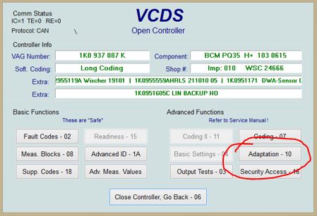

I noticed these options in VCDS Byte 19. I see the headlights and tail lights can be adjusted, does anyone know if the brake lights can be too?
Have you tried looking in the Central Electrics 09 >> Adaptations? Most of my experience has been on MQB cars so not sure if it is also possible on Superb II, but on some of the lighting channels you can change the % brightness. Just need to find out what the brake light channels are though.
Ah, OK, I've never looked in there, is this it?
Adaptions give u no options about lighting. Just deactivate the dimming!! :)

Do you reckon changing from A0 to one of the others will increase the brightness of the tail lights?
Yes. Inactive will give u more light. If the eprom is 100% and not dimmed. ;)
