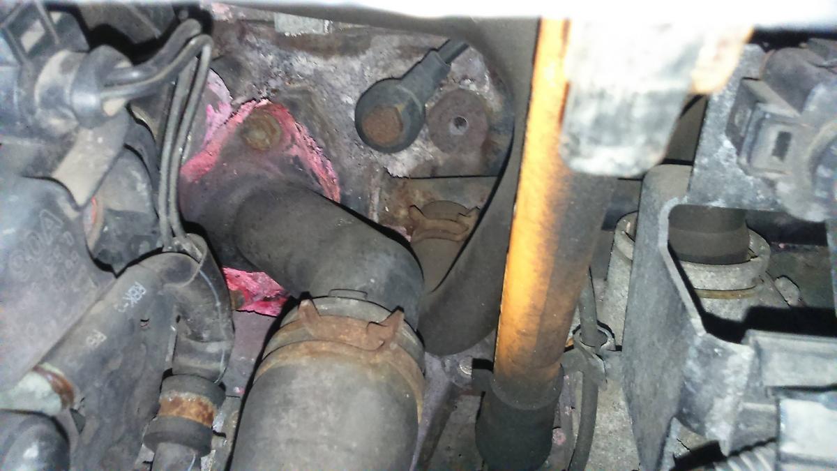

hi, i recently left work to find coolant bottle was nearly empty so i filled it back up& drove it home. had a look under the bonnet & couldn't find the problem but noticed this pink stuff by the pipe which goes into the engine to the bottom of the radiator. any ideas?post-131133-0-18251600-1444417599_thumb.jpg

You have found your problem, that pink stuff is dried coolant.
the thermostat is behind that - might be worth changing along with the gasket and plastic pipe to ensure it does not leak in future
Ok thanks... Just wondering when I drove it home good 20 mins or so.. I looked straight away but wasn't leaking?

Its an easy enough job, as mentioned youll need thermostat, o ring, plastic elbow if yours has cracked.
And some quarter inch bars with wobble end and I think its a 5mm allen socket.
I was just going to remove the inlet to make it easier and whilst it's off give the inlet a good scrub and clean the inside of all the Crap.
I had a look yesterday and the inlet doesn't seem hard to get off.
Got the housing pipe, gasket, thermostat and 2 litres of red coolant for 19 pound.
