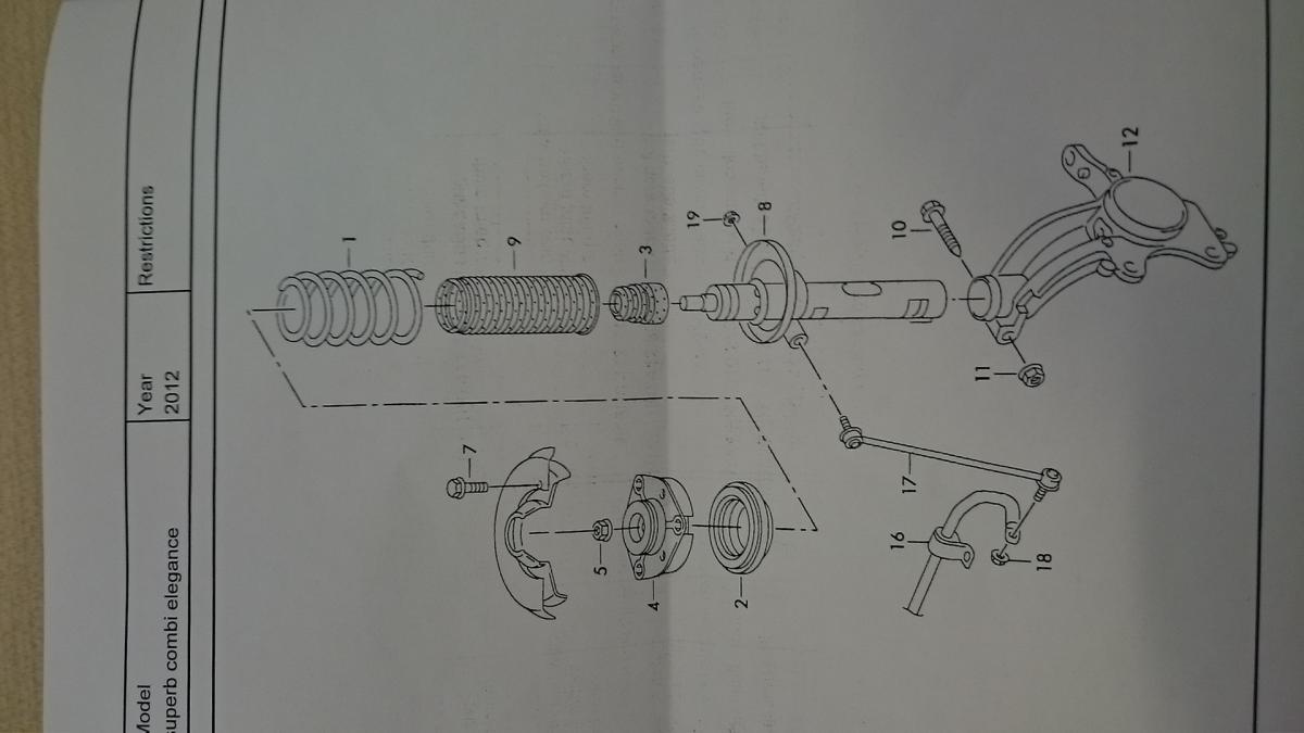

I am having my own expert inspection on the 23rd but in the mean time I have had a look and to me, an untrained eye, it looks like the left and right shocks should be left handed and right handed, due to the position of the drop-link' mount, but both shocks on my car are identical.
These pictures show that the drop-link' mount appears to be backwards on one side meaning that the drop-link' is attached in a different place on each side. The angle of the drivers side drop-link' is quite a bit more acute than the passenger side ....

I agree with you Andy - it looks like the uprights are the same i.e. Not left and right handed. Great photos by the way :)
It would explain the noise you outline if the whole strut is being pulled/pushed off centre with brake and acceleration forces (if that makes sense).
I'm no expert but something quite simple looks amiss there which hopefully is a good thing.

Hi, have looked at your photos. Sorry, but everything is mounted right.

Oh. Even though the drop link is mounted in a different place on each side of the car?
The left and right shocks are also identical in every way, which doesn't look right as this makes one of them orientated wrong and the drop link mount face the wrong way.

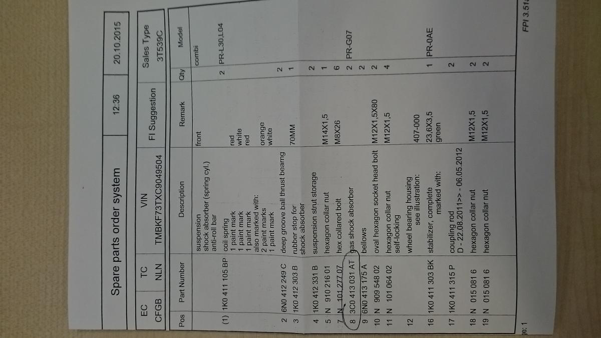

The part numbers are identical, which looking on the internet is not correct. On older shocks such as mine with a date of 12/01/2012 on them, there are left and right sided ones for sale on the internet.
New shocks from Skoda Parts now have a drop link mount on both sides so that the shock can be mounted on either side, but the old ones as on my car are only one sided.

Europarts lists 1 part number for either front shock absorber on mine, i.e. not handed
Ditto front drop links

Your right that euro parts has only one part for both sides, and the pictures of these parts look like the ones fitted to my car, but if you look at Skoda parts website, their new shocks have a drop link bracket on both sides which tends to suggest they have updated their shocks to be either handed, rather than one handed.
http://www.skodaparts.com/product/superb-shock-absorber-front-200-2015-50944
With just a one sided drop-link' bracket, as you can see in the pics above (thanks for embedding in a post!) The droplinks are attached at different places, causing one drop-link' to be at a more acute vertical angle and make the distance between mount and roll bar a slightly bit longer. Wouldn't this tighten up one side? As the drop-link' isn't going to be any longer is it, its just going to pull up the antiroll bar on one side.
The part number on both my shocks is 3C0 413 031 AT and they both have the date 12.1.12 on them.

So as it appears, the shocks on my car are indeed correct - one part for both sides.
Still think it's odd the droplinks attach in different places though!
