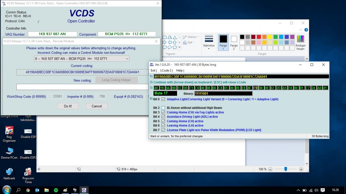

In 09 module u can tick on a bit to use halogens as secondary highbeam. Do the halogens work at all?
I don't remember exactly how, but I can check when I'm finished working today :-)
Here u go. ;) Bixenon without additional highbeam must be unticked :)
Mybe thats whats wrong with it ill try to fix and i will tell you what is the result thanks a lot
I hope it will fix ur problem:-)
