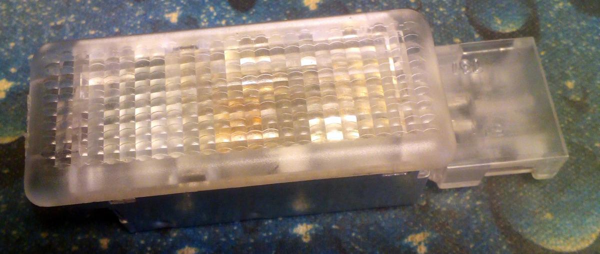

I'm in the process of changing the internal bulbs to led.
I really stumped with boot bulb.  I have removed the bulb unit but for the life of me I cannot see how to remove the bulb from the unit.
Is there anyone how can shed some "light " of this.
Attached is a picture of the bulb unit i am trying to remove the bulb from.

Hi Mike,If you go to top of the page you will see " search" , put in LED INTERIOR LIGHTBULBS. This will help, just have a couple of plasters handy. :notme:
Pop the metal casing off the rear and it will reveal the bulb.

I will have a go at dismantling the unit, seems overly complicated just to change a bulb.

You need to bend out the metal case a wee bit from the clips at the Base of the plastic cover. As above plasters are an idea as is a spare fuse.

No need for a spare fuse if you remove the wiring plug from the light before changing the bulb... not to mention it will also be easier.
