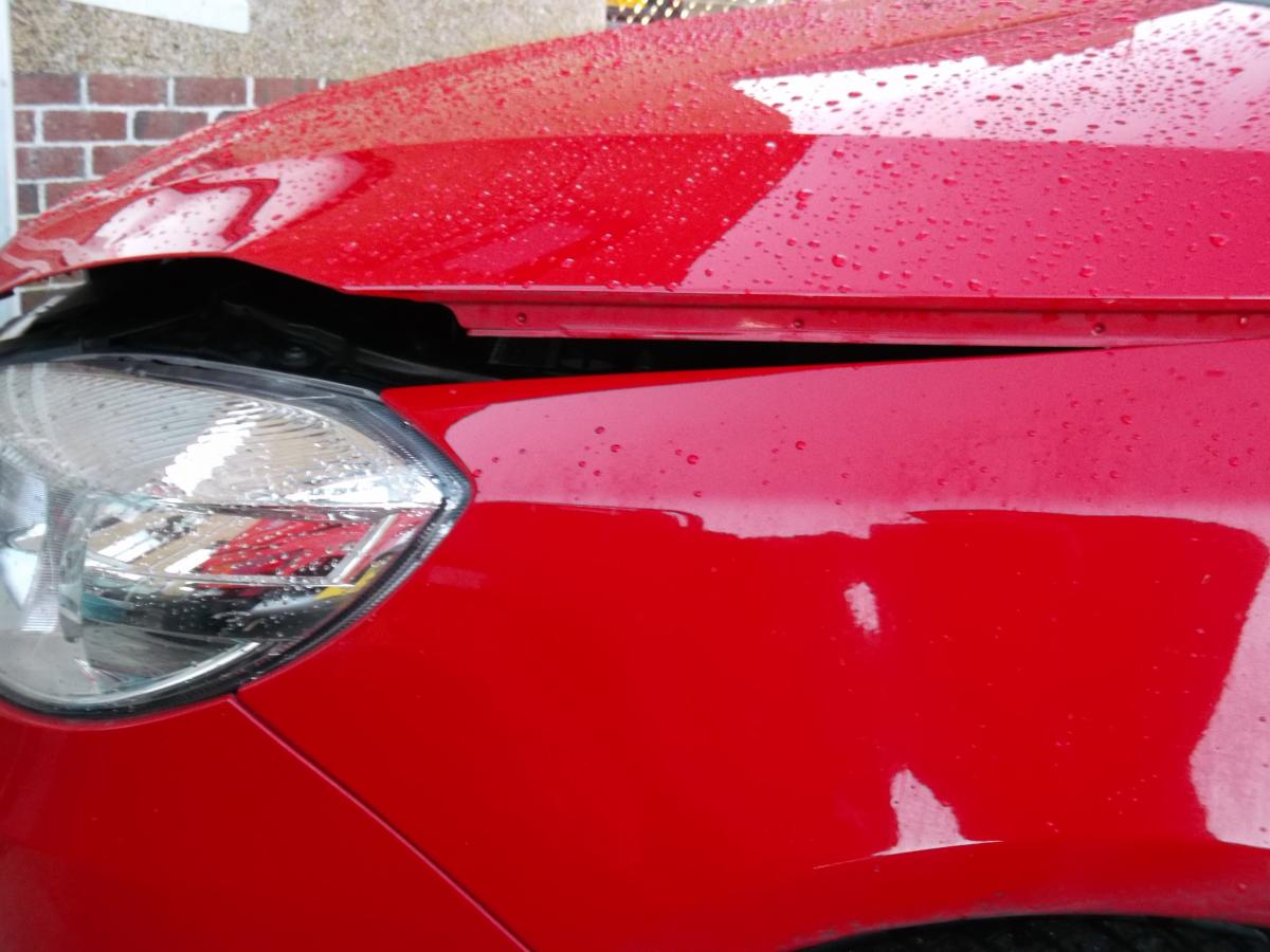

Passenger side headlight showing bonnet touching:
And the same on the drivers side:

I have since raised the front of the bonnet so it isn't touching the lights  but obviously that doesn't really solve the issue.

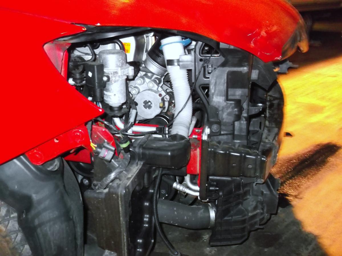

Something is not quite right about your bonnet ? Looks like the bonnet is twisted?
Or like you say the bonnet isnt sitting on the main frame so throwing everything out

This is the correct alignment on a new replacement bonnet,  which has 2 bolts on both new hinges after a front end prang.
The hinges usually distort.
(your front slam panel looks like it has been off.  are those the original Bolts?
Thanks for the replies, good point about the bolts, I don'd know if it has been taken off although as mentioned a HPI check says it hasn't been involved in an accident, but of course that isn't the be all and end all. All the other panels look correct though, the wing to the door, the light to the wing and the bumper to the wing and the light ect are all correct so I don't think the front end is out of alignment.
A HPI check need not show the car has been in an accident.
The one i posted would not,
would your last car come up as being in one?
If it is near aligned then just adjust it a bit more.
Lots of people remove bonnets to work on the engine, and especially to remove an engine.
Has your new car had Warranty Work done on it,  have you checked?

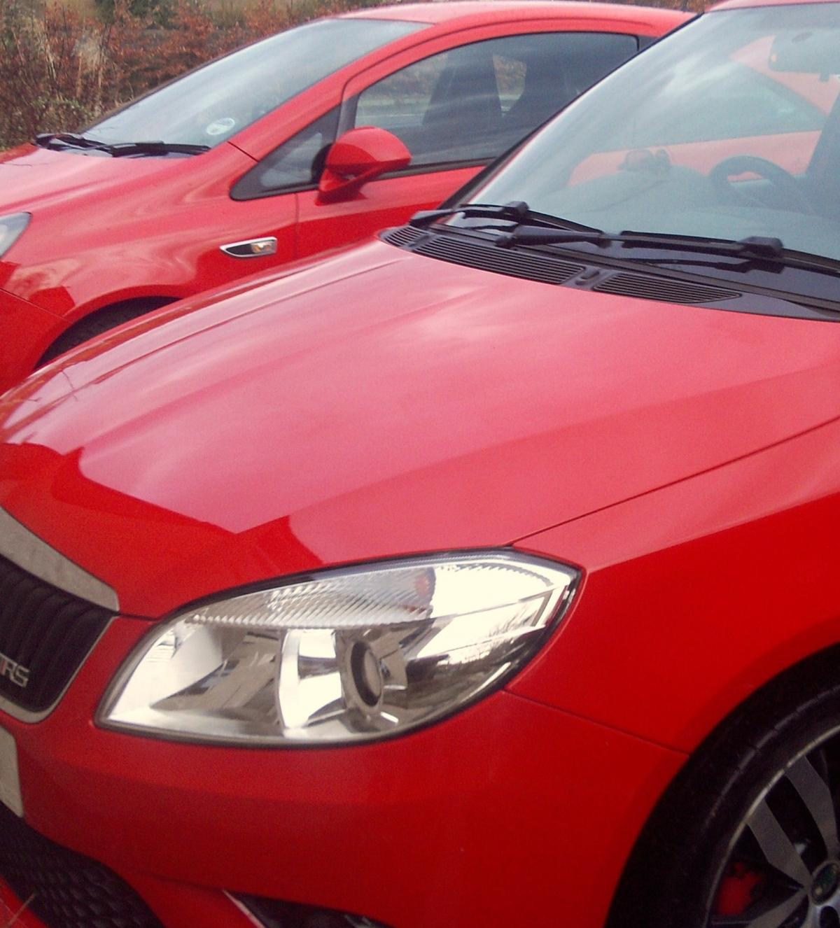

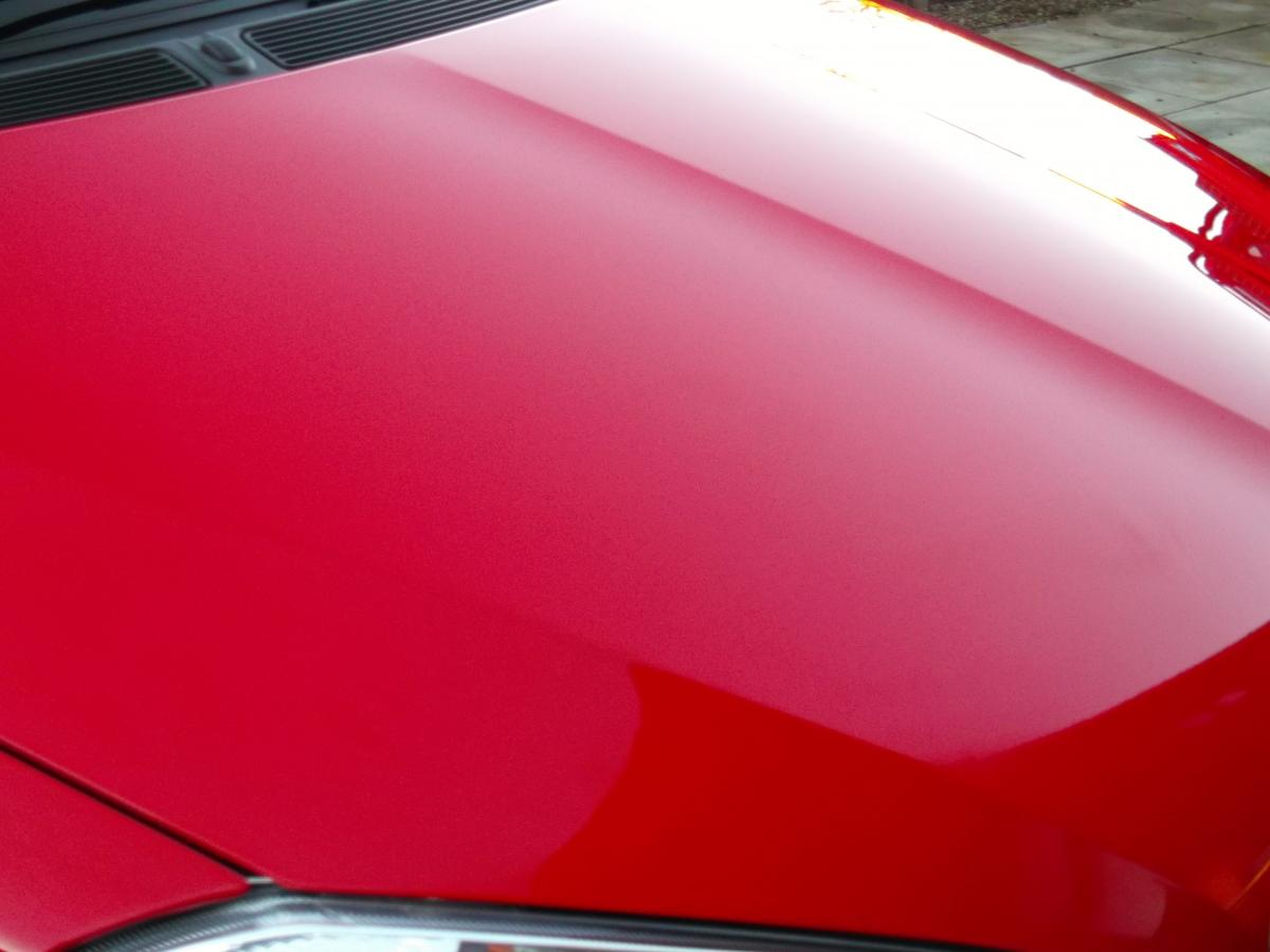

Have you got any straight on pictures with the bonnet shut and also a shot across the back of the bonnet when shut?
I have these pictures from the front but I don't have any from the back, I'll have to get some when it's light again:
Looks good, bonnet maybe needs back 1 mm & a bitty.
Loosen bolts on hinge a little give it a gentle tap with palm of your hand.
(as we call it,  'just a bas hair')

I have a couple of photos for you showing the panel alignment:
Although the last photo looks aligned properly there is room to move it back a bit and I'm sure it's further back on my dads but he's out at the minute or I'd have a look.
