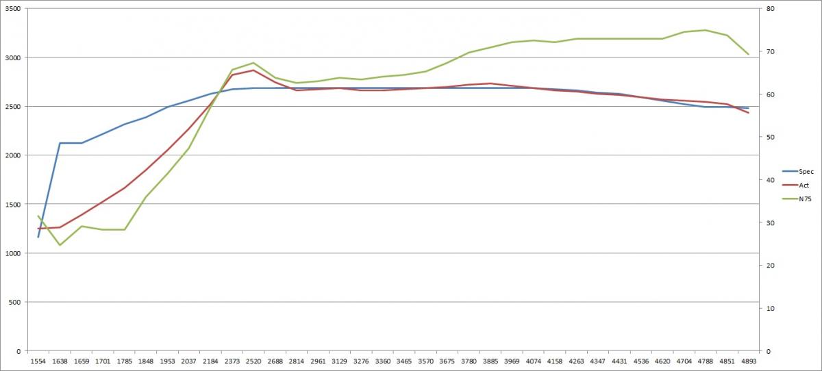

gt1756 (not GTB) from XMAN performs well. Currently mapping one at the moment. Below is a boost graph of it running 1.7 bar still work to be done on it with final boost to be 1.75 bar. I recon good for 200-205bhp with little smoke.

Out of interested did you measure it on a dyno?
Yeah, I had print outs, pretty sure I've still got a picture of them. The print out went with the car when I sold it.

Xman only quotes 1.75 with 1.85 peak for his turbo so that's what I'm mapping it too. Turbo dynamics quote higher at around 2bar which I've had 2 dyno at between 220 and 230bhp again with low smoke levels.
