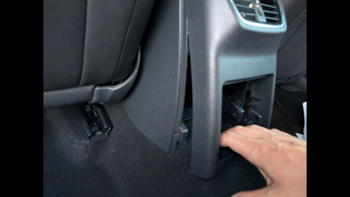

Hi guys, I need to remove the rear vents as my 3yr old filled them with sick earlier lol.
I have popped the ashtray out and removed the two torx screws. The bottom half is free, but cannot get the top half off.
I have attached a pic:
Pull the grill out at the top, should pull out very easily no effort. There should be two screws behind it ...
Thank you very much.
