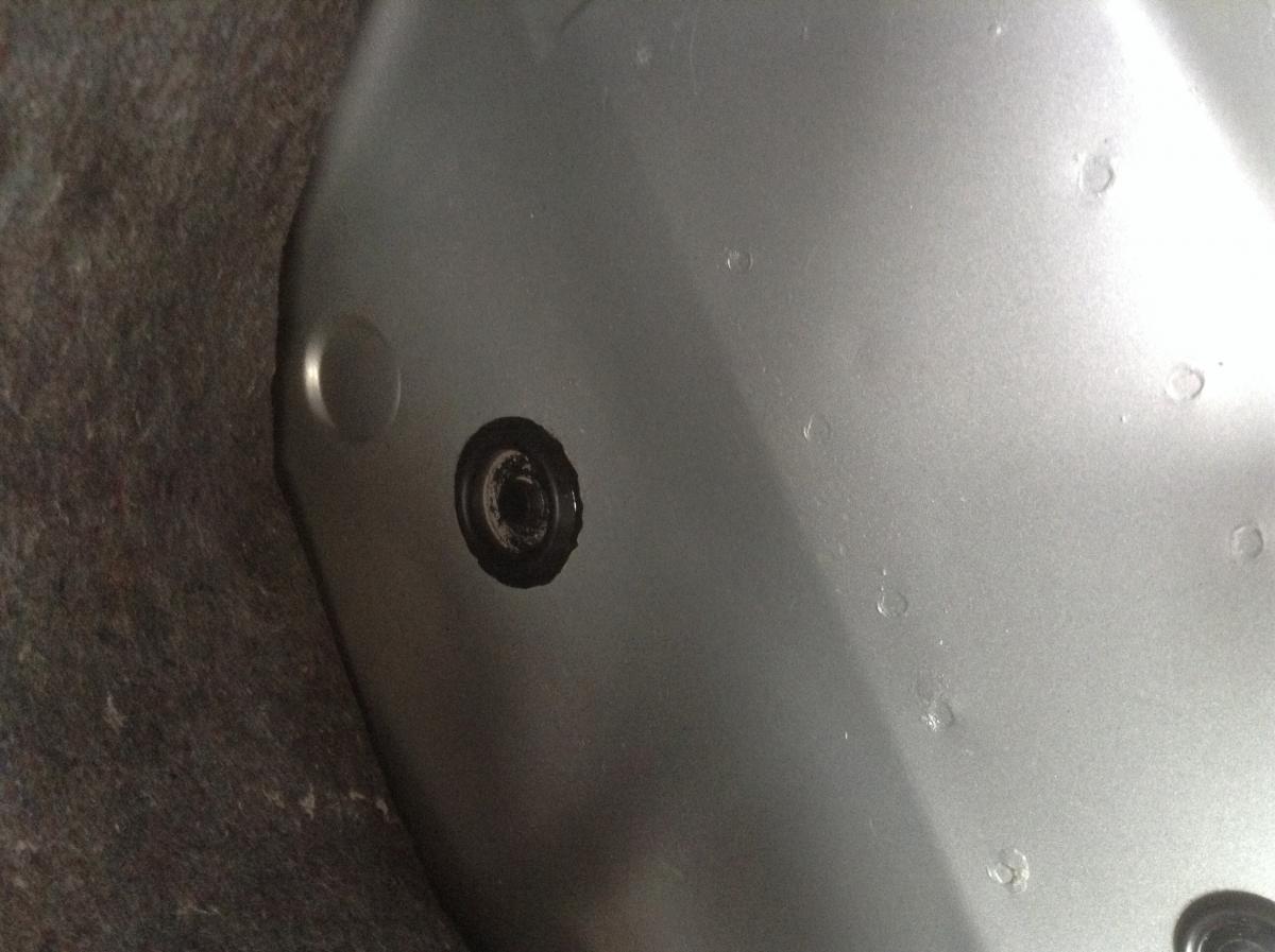

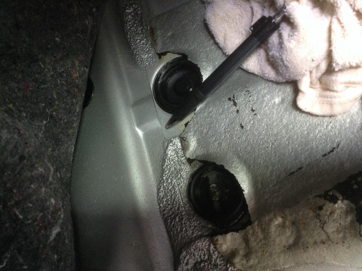

I had water in my passenger footwell last year so pulled out the seat and the sound proofing as it was soaking wet and I had water running in via a hole see picture also my turbo gave in so the mechanic cleared the scuttles out and it's seemed to have cured it so far. See picture.post-95448-0-50613800-1446683921_thumb.jpgpost-95448-0-00041000-1446684018_thumb.jpg second picture is in the rear footwell, I popped it out wiped it over and replaced back in.
