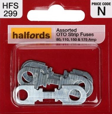

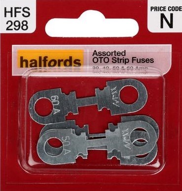

On top of the battery are 6 fuses, No 5 is the PAS.
In checking the 10mm nuts either end I heard a spark sound.
The fuse plate looked intact, but in fact there was an almost invisible hair-line split half way along.....
Connected some wire between the two nuts.... bingo!
All sorted.
I'll be ordering a new fuse plate directly.

Yes they certainly can develop very fine, virtually invisible cracks. Shame you had to go through all that work for nothing but at least it's working now 👍
Halfords sell packs of the fuse strips.
