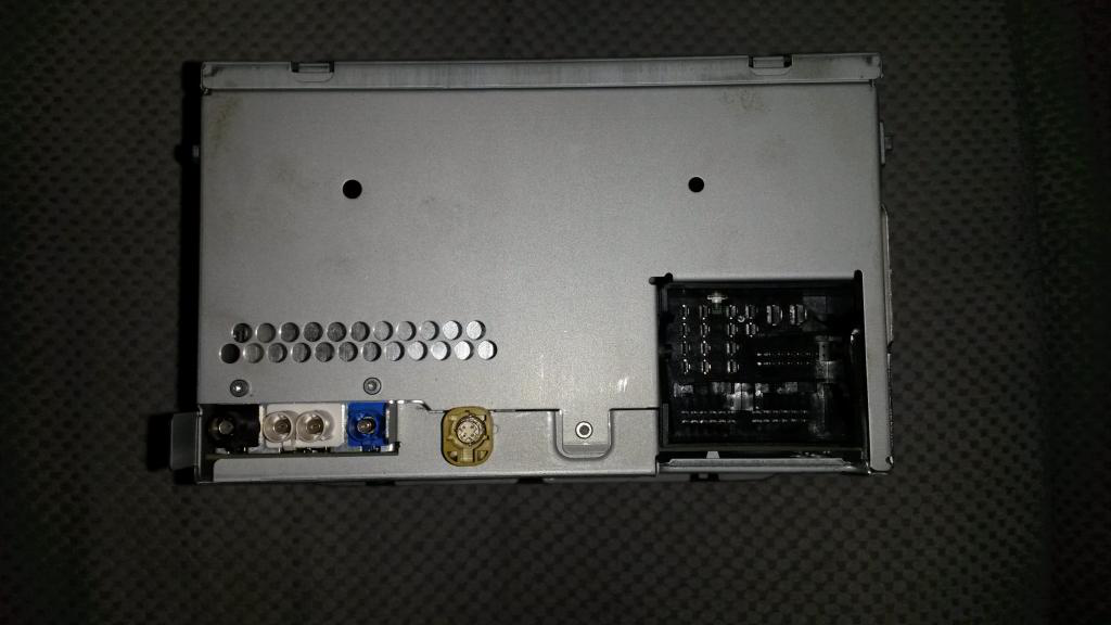

I found the following image of the rear. Looks to have an extra connector in the quadlock and then USB/DAB/GPS/AM/FM. There isn't an obvious connection for an RVC so that might explain the different quadlock.
A VCDS scan of a Yeti with one fitted and it's pinout would be great at the stage, anyone know of such a Yeti ;)

Looks like it will physically fit but needs component protection removing and navigation activating. Probably worth waiting a little while until it's fully understood for MK5/MK6 golfs as it should be similar for the MK2.
