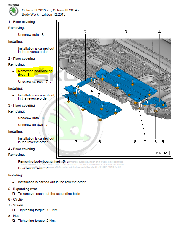

Anyone changed out the underbody trim ?
Debris on the road cracked mine, so I may need to replace part no.3. It looks pretty straight froward, but I'm not sure what the "body-bound rivet " is. I'm assuming panel no.2 needs to be removed first so this rivet would need to be removed and re-installed.

You are reading the diagram wrong! :D
Part 3 floor covering remove nut & screws items 7 & 8................10mm spanner & TX star 25 or 27 .........had all mine of to waxoly behind easy job............
also item 2 it a totally bigger & different shape with item 5 being a push in plastic rivet & easy to undo
