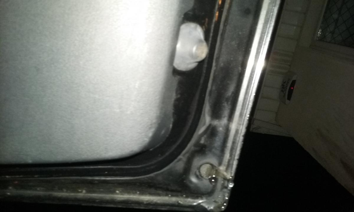

I had water gettin in too, but it was inside the hatch space ie, behind the trim panel, from the washer i reckoned. but i think it was getting in via the hinge housing up top..
I pulled the 2 bungs out of the bottom of the hatch and its been fine since.

I have started getting a major water leak into my boot too with this mad rain, where are these bungs you mention? I had a good inch or two of water in the foam compartment section under the boot floor!
Ill have a look in a minutes to double check, but are you sure its not coming from the washer hose joint to the left hand side of the boot behind the carpet?
pretty sure, as the pool of water was in the right hand part of the underfloor, the left was dry
Sorry got way laid last night!!
The hatch bungs are located right in each corner of hatch, below and to the outside of the bump stops.
Just yank them out and job done
