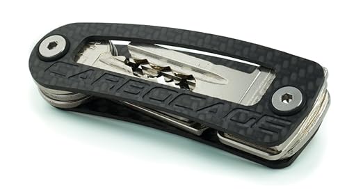

Then I only go out with the house keys, all other keys are kept in the house separate, as I said I hate carrying keys of any kind, especially if they have silly fobs attached.
I have one of these to keep the house keys in,
I only keep the car key in my pocket.
That's a neat idea!
I use Key Ninja. Groupon usually have a deal with them (approximately £8), it's got an LED torch either side and a bottle opener!
I was thinking there may be some sort of generic hard case that the car key could fit into to stop buttons pressing accidentally when in a pocket. Had a search on Google but couldn't really find anything suitable.
Yes a carbon fibre case would be nice, then the buttons would be recessed, hopefully someone might make one at some point.
