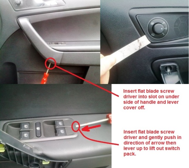

Thanks for your nice instructions on removing the front door card. I do, however, fail already on step 1. I feel that so much force is needed to prise off the handle that I am afraid breaking the thing and this is after releasing the locking mechanism with a screwdriver as you describe.
Could you please elaborate a bit on this step.
Thanks in advance
H
Hi Hakelm,
The handle does need a strong pull to remove it. Try warming the handle with a hot air gun/hair drier to make the plastic more flexible.  Whilst levering it also pull at the top of the handle directly away from the door.

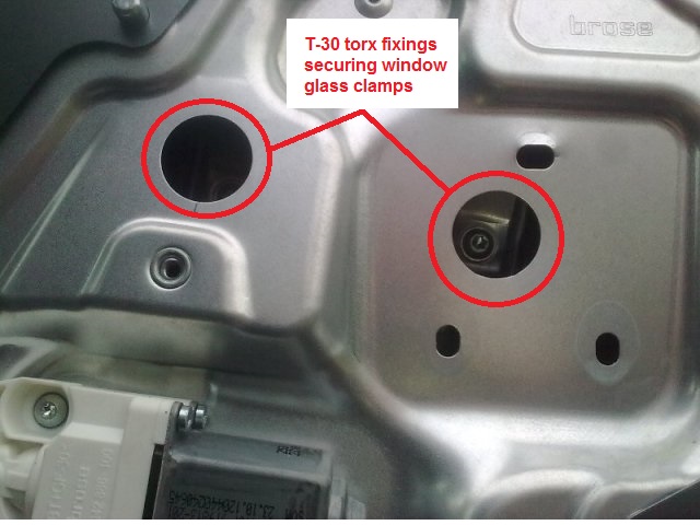

I am still stuck with my door card. With some hot air the handle came off nicely but I can't find the upper T-30 screw. There is only some kind of black plastic cap with a hole, see attached picture. The cap sits on some kind of hinge but can't be removed or moved up and down more than a few millimeters. I can't see or find any screw behind the hole.
Do you have any idea how to tackle this?
Håkan
The cap can be removed with a bit of hot air and some force. Behind the cap the missing T-30 can be found. I prised it from below with a screwdriver and a somewhat too large force so it broke. Some thermal glue healed it. If you are doing this prise from the top.

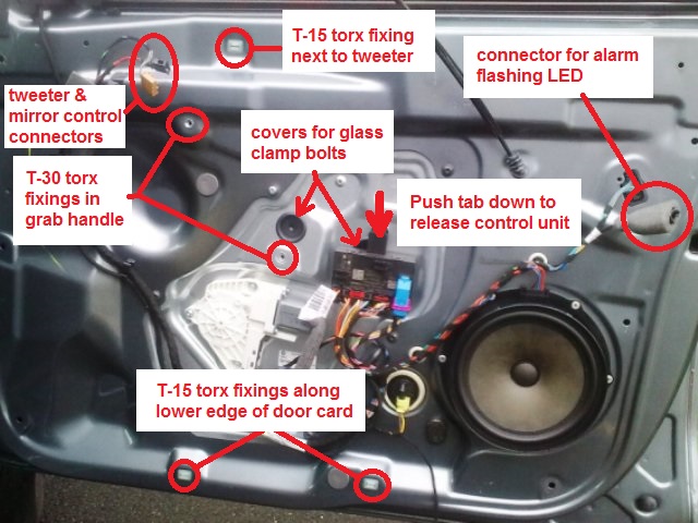

Thank you for this comprhensive post on removing the door cards. I particularly need help with item 3 for the window switch, but can't see any of the photos you say are included. Which end do I need to prise to get the switch out?
