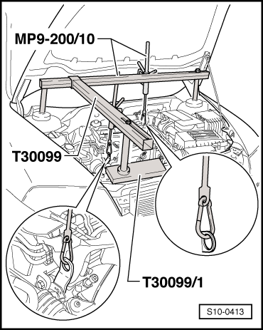

Be careful when using the cross car supports. Don't put them on the wings. The proper equipment goes across the strut tops where it is strong enough. The hook is on the front of the engine by the tandem fuel pump. I normally use an exhaust clamp through the eyelet to hold it on.

It's basically a T shaped bar. You take the scuttle trim off and it locates in the strut tops and then has another bar that comes forward to the front panel. The wings aren't strong enough to support the engine and will buckle.

Skoda will sell you a genuine one.

Two 4 by 4 poles arranged in a tee as the genuine tool should do the trick.
