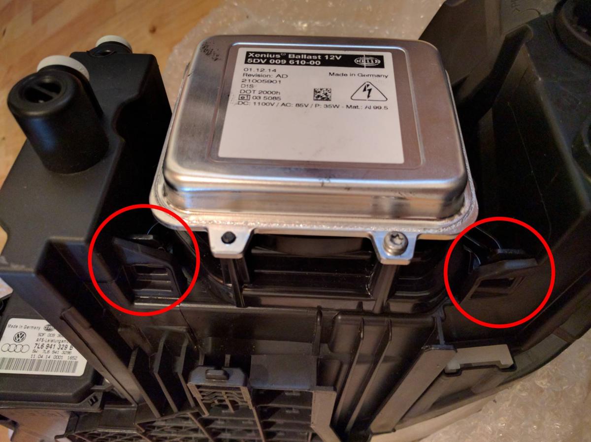

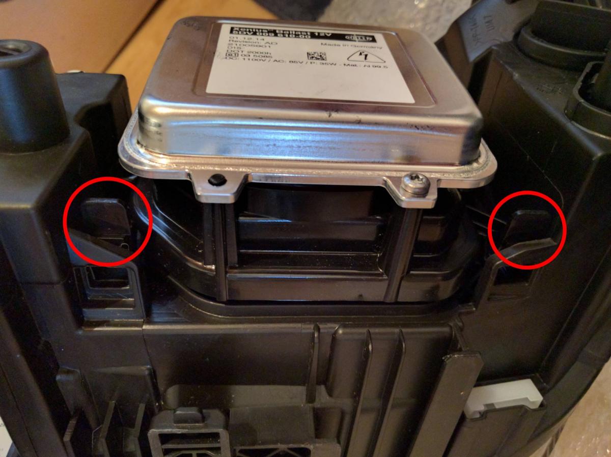

Top clips (closed/opened):
post-121621-0-68885400-1455696789_thumb.jpgpost-121621-0-10374200-1455696796_thumb.jpg

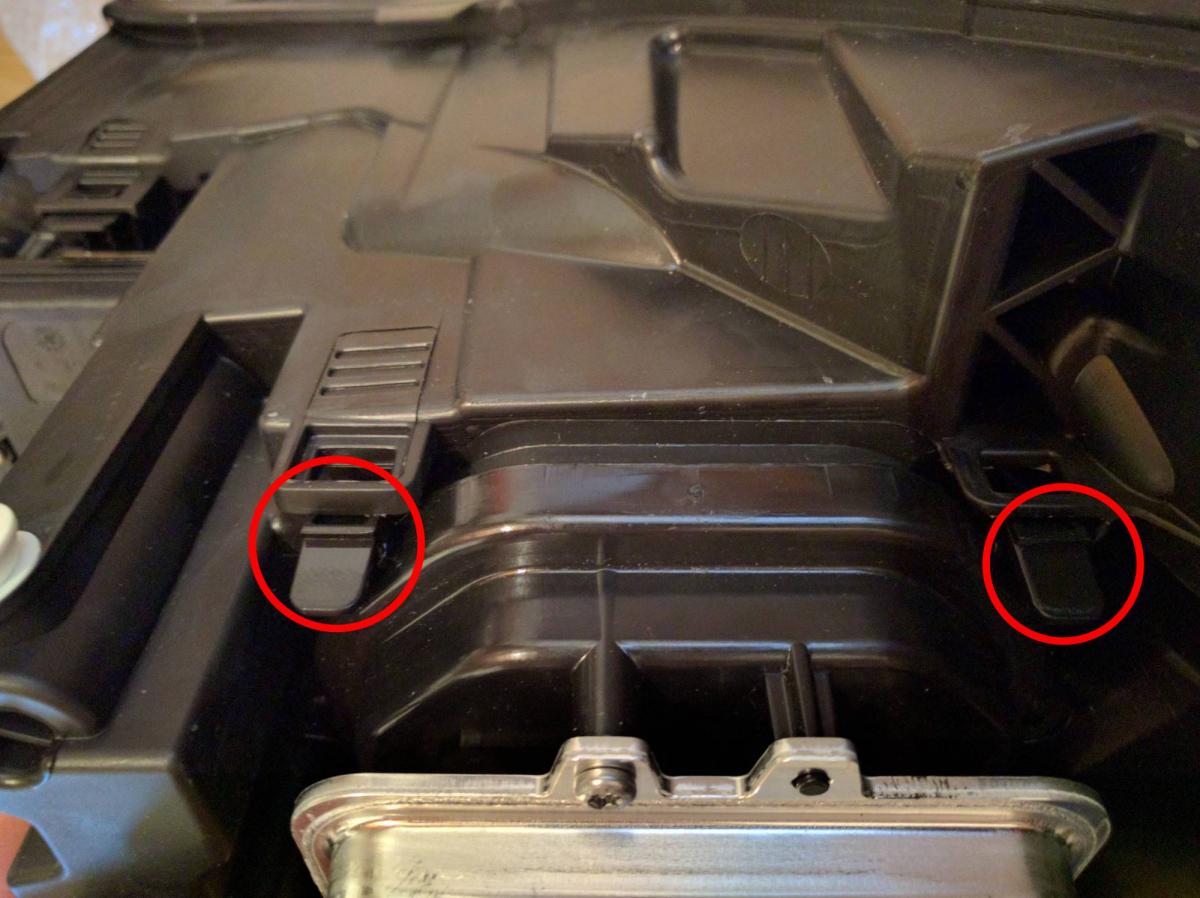

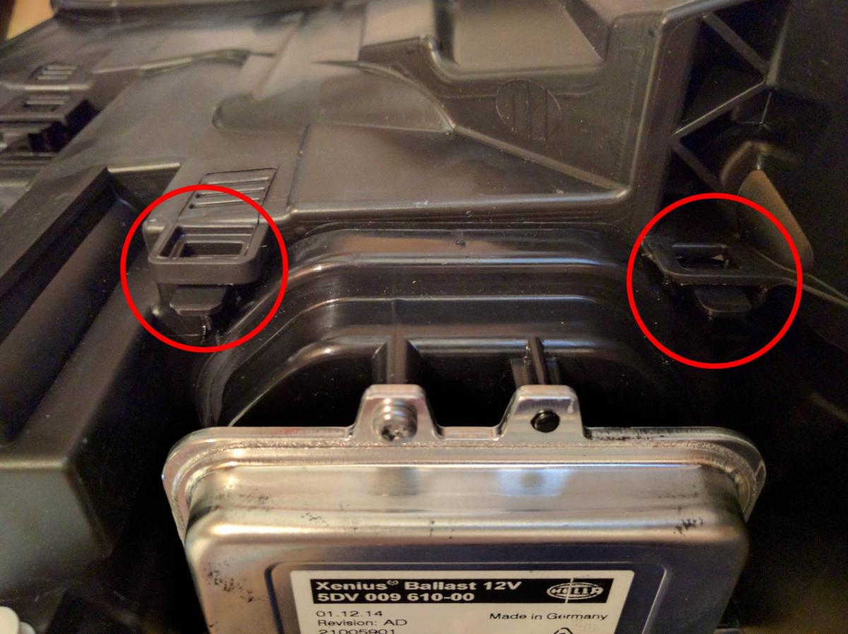

Bottom clips (closed/opened):
post-121621-0-88867800-1455696803_thumb.jpgpost-121621-0-73934800-1455696810_thumb.jpg

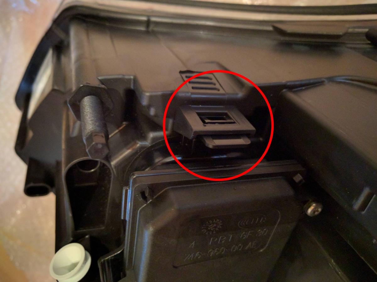

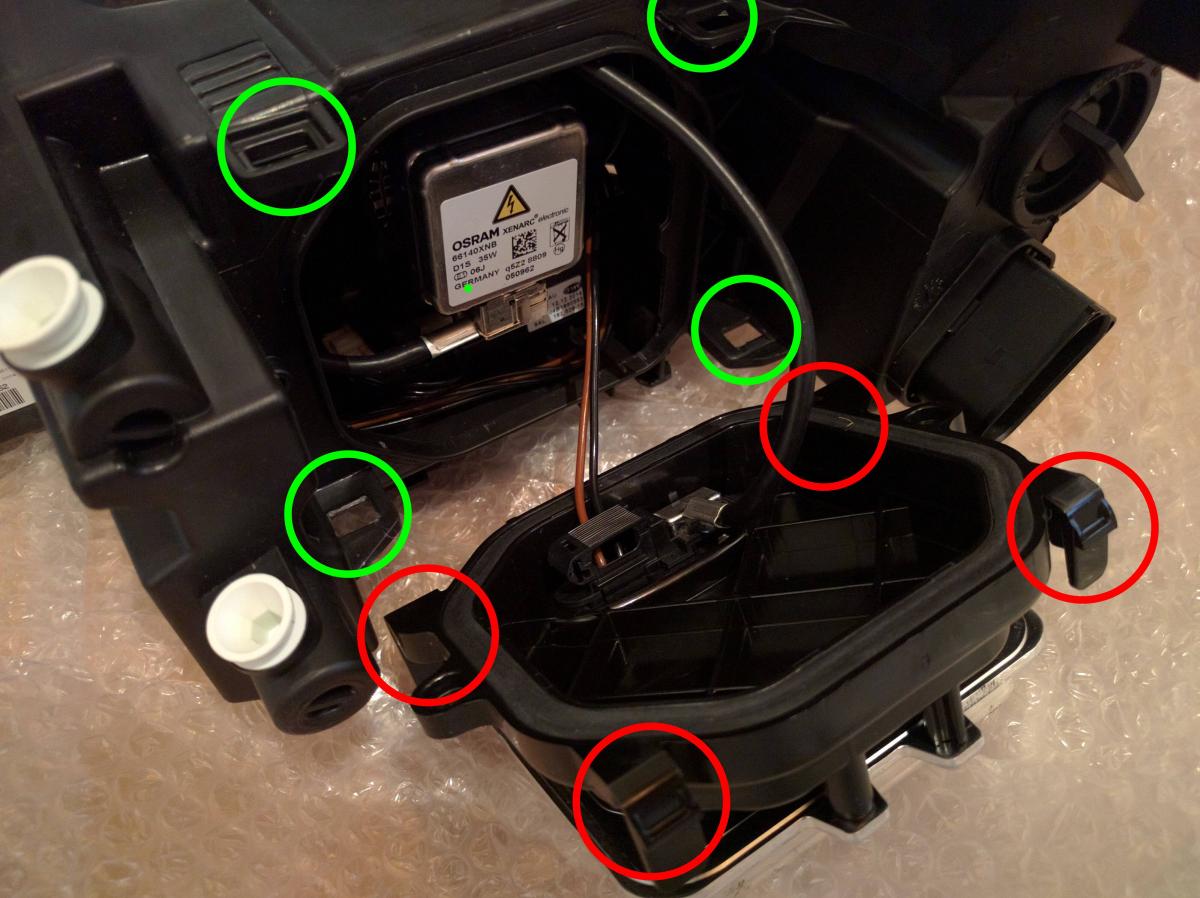

Panel removed:
If you ever need to do the main beam, the clip is here:
