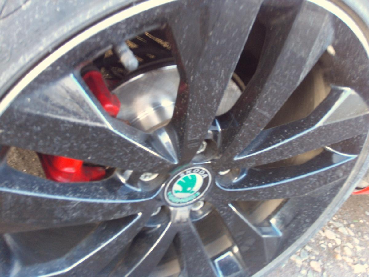

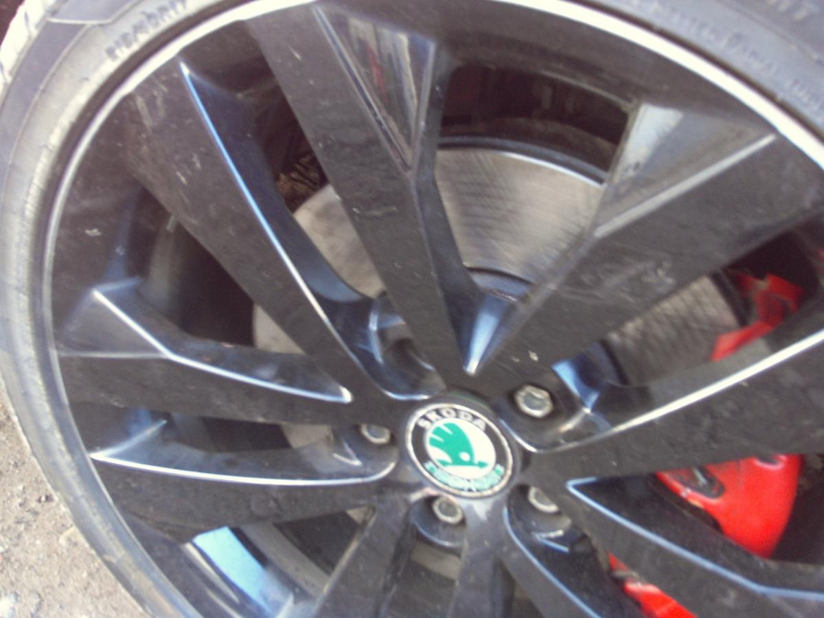

Often new discs are coated with a special paint (ATE does that) and that doesnt have to be removed. Just carefully brake it off.
Will give some strange noises at first, but that is normal.
On my picture you can see the new discs, still with the coating.
Indeed  'magic', it seems you are right!  :clap:
It seems that Ferodo's range of 'Coat+' discs have a painted coating and not the usual thin, removable, oily protectant.
