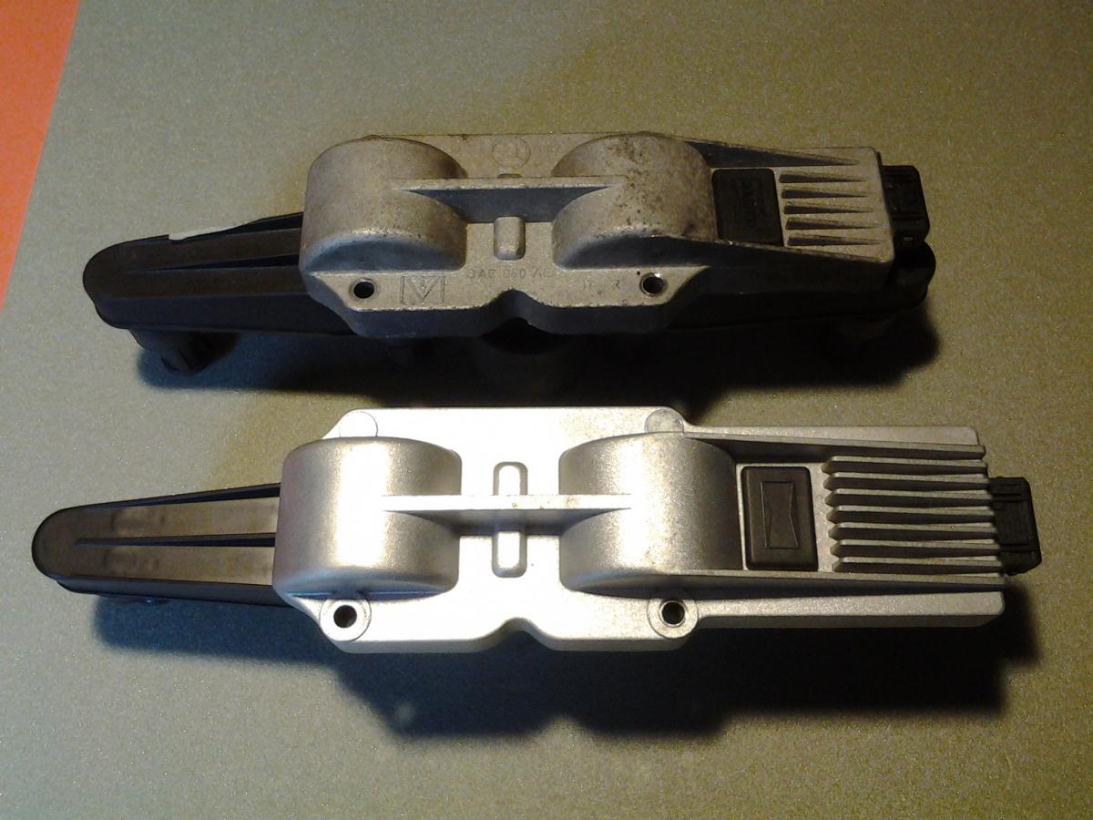

1.3 pick up , coil pack
Great reply, thanks ricardo.....tomorrow's job is to open up both coils, just as you have shown in the pictures, will take some pictures and post on here .........thanks for your help......going to search youtube now for soldering tips...

  • Do you feel confident enough to try repair the coil pack(s) ? They are super simple inside and you could make a good coil pack from two bad ones. If you decide to follow this path, let me know and I w
Start by opening the old coil. Use that experience to do the best job on the new coil, as you want to use it on your pickup. Have some silicon handy too for assembly phase.

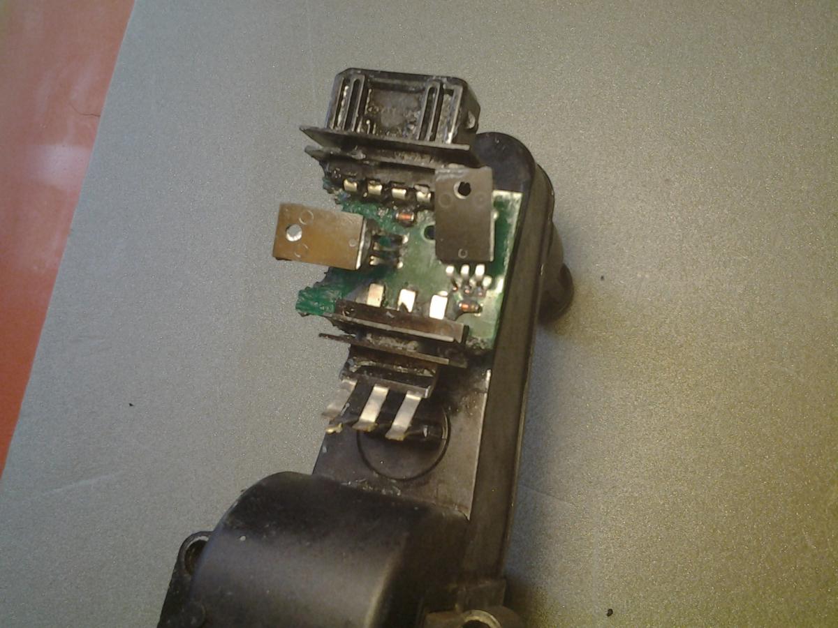

Drilled the rivets this morning, before I drilled them I tried both coils on the car too double check the faults, both coils are not sparking on cylinders 1 + 4.
Drilled the rivits on the old coil and parted the two halves, bit messy with all that silicon but got there in the end, broke the join on one of the transistors in doing so and also on of the linking tabs to the 2 fat transformers...this will be my spares coil, will be more carefull with the good one....
a question for RICARDO, you have mentioned replacing the "power transistor" would that be one of the small black boxes soldered to the circuit board at the 4 pin plug end of the coil pack ?, see pic 2

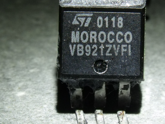

Yes, Paul. I thought you know how a transistor looks like. But nevermind, we'll take it slowly. First of all, I need you to tell me if each transistor is marked VB921ZV. Then tell me why the heatsink of each transistor is so clean and shiny. There should be thermo-conductive white grease for good heat transfer. If there was and you cleaned it, it's OK. But you have to smear the heatsink with thermo-conductive white grease before reinstall. If you haven't any, you can find at any computer parts store in a small tube. It's very cheap.

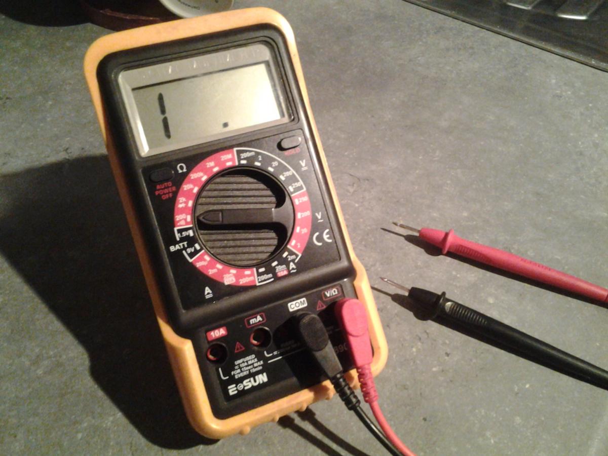

Hi ricardo.....thank you for the links and your time for putting that chart together , think I'll be ok with the multi meter, used it before for various tests but nice to have a reminder, need to get myself a new , suitable, soldering iron,that will have to wait until the weekend, very busy at work at the moment , no time for shopping trips but easter weekend this week which means a couple of days extra off work.......
a piccie of my multi meter, will need to re-solder the transistor on the old coil but I will try and test the newer coil before the weekend and post the results on your chart......thanks again for your help
The multimeter will do very well for our purpose.

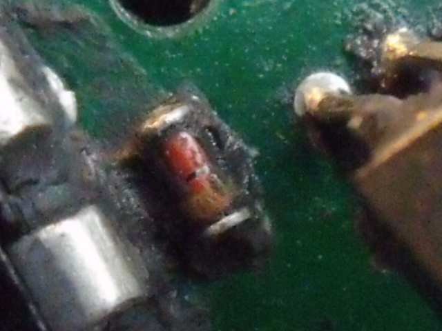

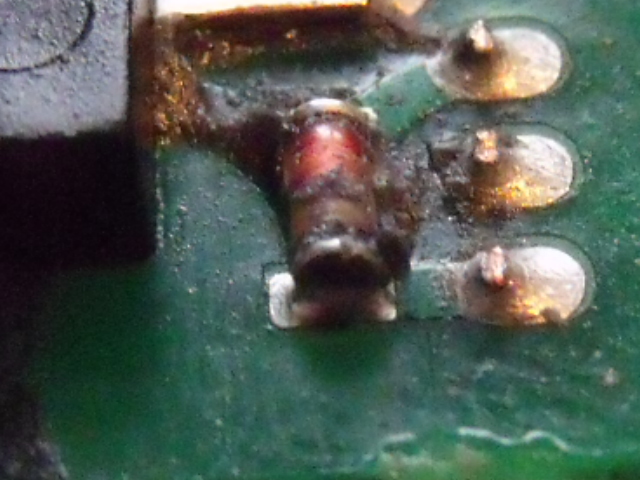

Paul, could you take very good close up photos of parts I circled in red? Is there any marking on them? Any signs of cracks or arcing? If possible use a better camera because the focus on previous close up photos is not too good.
Oh, and don't forget my previous question about the markings on transistors.

hi ricardo.......ive done a few tests this morning and also taken a few pictures,origanal pictures i took with my tablet these pictures ive taken with my digital camera,a lot clearer  :thumbup:

pictures are from the old coil,not looking good
I thought I see something on previous picture and now we have the confirmation. Those components are diodes. At least one diode look shot from 1) dirt and moisture forming a conductive bridge and 2) the intermittent short circuit in connecting cable. They need to be removed. There is a big chance that both 'transistors' are good and only one diode was shorted. In fact there is no need of diodes. I have photos of a coil without them (from factory). To me it was a surprise seeing them. See note below. By adding those diodes conditions are met for a 'programmed' failure. They short easily and people buy new coils :swear:
Note: I called the 3-leads black components 'transistors' for simplification. In fact they are power Integrated Circuits. You can see from the datasheet that they don't need external components (no diodes) and that they are very rugged and well protected.
The measurements confirm that one diode and/or a junction of one transistor are shorted. I attach the schematic of the 'coil' for better understanding.
Bottom line: desolder both diodes, solder back the transistor exactly how it was and repeat the measurements. Chances are the coil will be 100% functional. Same thing for the newer coil. You might end up with 2 working coils. Remember that you have to assemble the coil exactly how you found it. The transistors need to have good thermal contact with the metallic heatsink to stay cold during operation.
