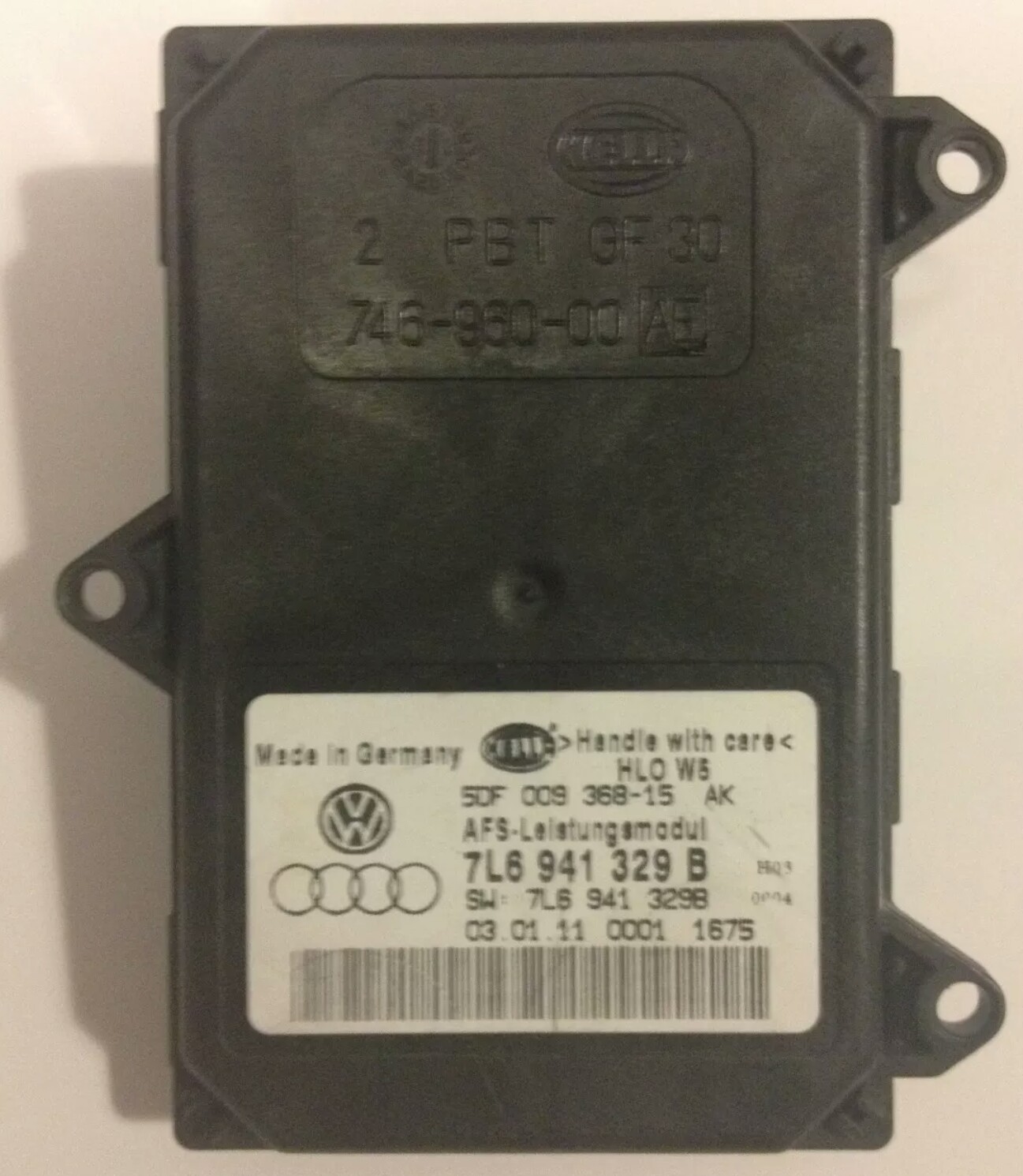

Hello lads,
I had problems in that department a while ago.
Problem was one of the headlights controller (see pic 1), located under each of them, got humidity in it and stopped leveling and was pointed down.
Skoda garage quoted me the big lottery prize at the time, as replacing that takes removing the whole bumper and the part was £280ish, I found one for £50 on eBay and had it done at a local garage.
You might want to verify the rear sensor (on the suspension - near passenger side), mine was broken (got a new one of cars-equip).
So skoda quoted for the whole thing: £600ish without the labour.
Fixed mine for about £150 with the labour.

On 14.2.2016 at 12:34, alextan said:
Hello lads,
This was my problem also, a crack in the headlight and all the water went down throught the haedlamp, and in to the ecu for the xenon
