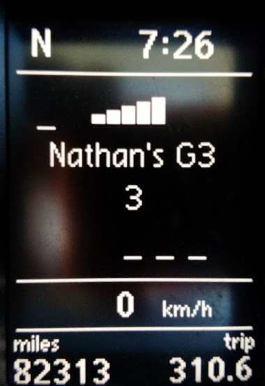

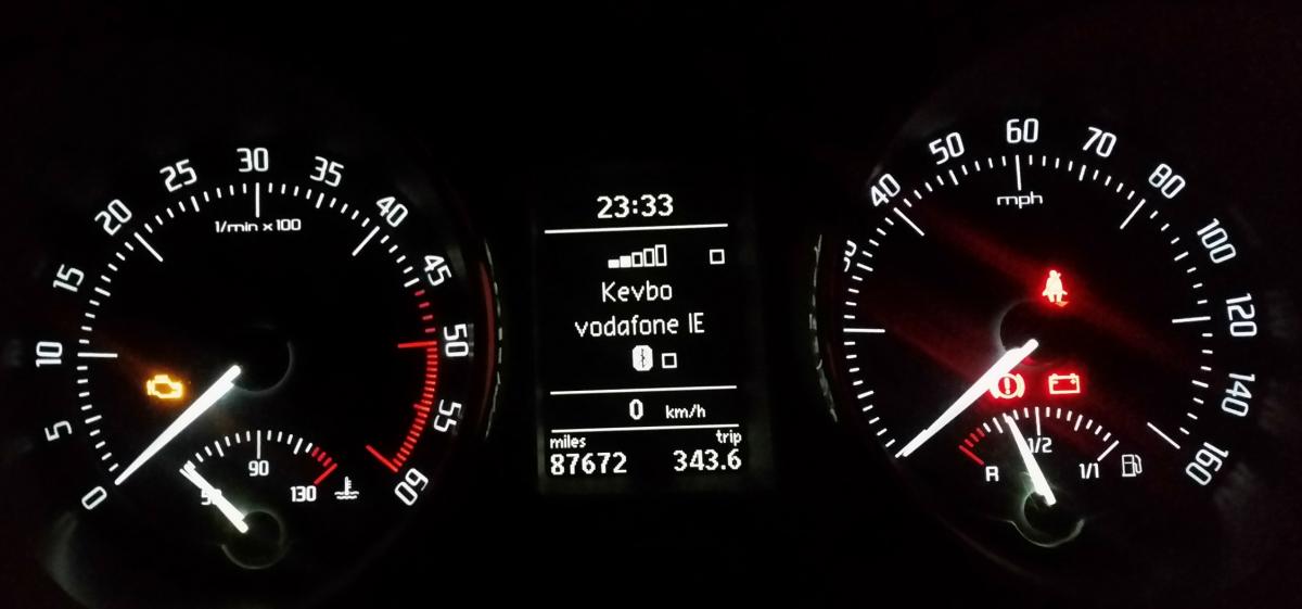

The 3C8 D/E modules are a few years newer than your car so it'll probably look like one of the following:
post-121621-0-76142600-1454923988_thumb.jpgpost-121621-0-64307900-1454923993_thumb.jpg

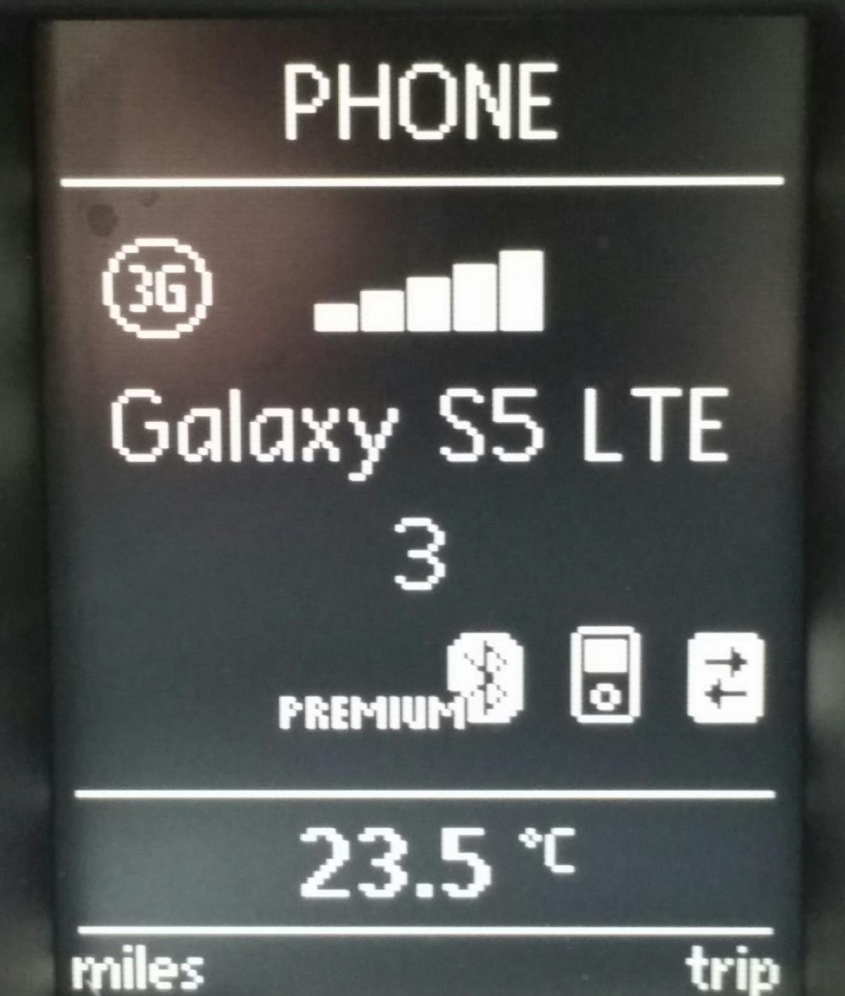

When it should look like:
As I say, there is no functional difference but just something to be aware of.
