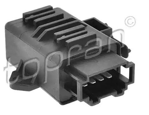

Ok i Think i have to take of the screws on the seat so i can lift it up. Becuse i cant check under do to it has like a plastic protection under the seat cant look under it. I wonder if it is this on the picture that i need to exchange.
You don't have to change any part. A cable is broken and you have to solder it. You should unbolt the seat. You have access to the cable from the rear side. You should take the fabric out of the metal plate and then you will see the foam. Dig it a little tracking the cable and you will find the breakage.
