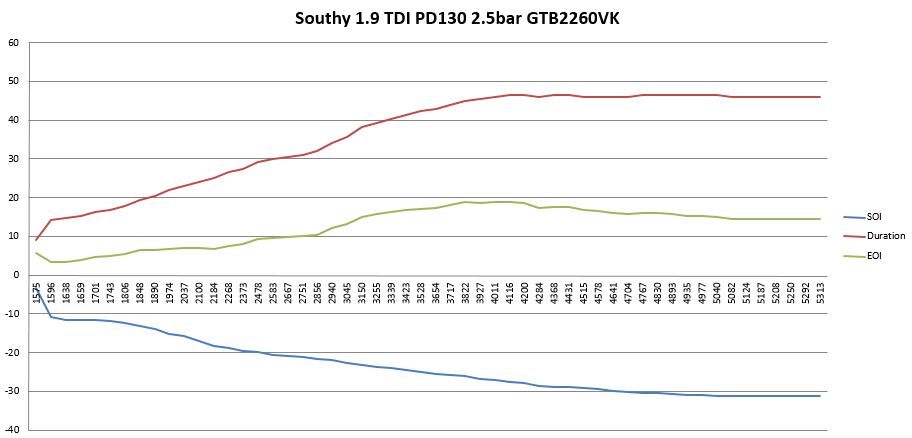

Start of injection hasnt been increased anymore than a basic remap as theirs no way to monitor combustion pressure. This does mean end of injection is later.
2000rpm = 7 degrees ATDC
2500rpm = 9 degrees ATDC
3000rpm = 13 degrees ATDC
3500rpm = 17 degrees ATDC
4000rpm = 19 degrees ATDC
4500rpm = 17 degrees ATDC
5000rpm = 15 degrees ATDC

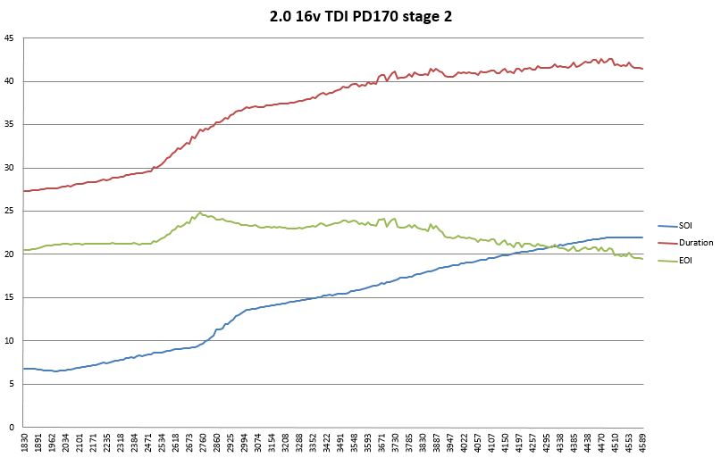

Comparing end of injection to a 2.0 16v pd170 with a stage 2 (hate stages) remap running 42 degrees of duration.
2000rpm = 21 degrees ATDC
2500rpm = 21.5 degrees ATDC
3000rpm = 23.5 degrees ATDC
3500rpm = 24 degrees ATDC
4000rpm = 22 degrees ATDC
4500rpm = 20 degrees ATDC

Surely you mean BTDC for SOI and ATDC for EOI?
Yeah. The numbers I posted are how far the injections stop injecting after top dead center. The graph just shows degrees not specific to BTDC or ATDC.
Duration is degrees length.
SOI is BTDC
EOI is ATDC
Edited by faboka vrs
Ok, this is interesting because if we want to retard the ignition point then logically we must begin SOI later than normal, but what you're saying is that this isn't possible with standard injectors because the EOI must be extended to allow sufficient fuel to be injected.
Therefore if we were using uprated injectors we could retard the ignition point and still inject enough fuel for a complete burn, so given the very high cylinder pressures and temperatures in a GTB equipped engine we can indeed move the SOI to be later and still get a complete burn with uprated injectors.

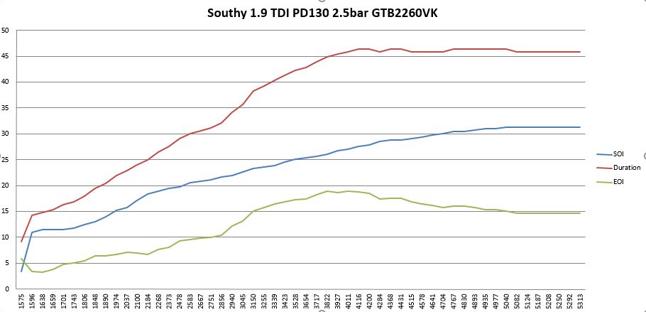

So this is Southy's but displayed a little different in case people are finding the graph hard to read.
- = BTDC
+ = ATDC
Duration is just length the injectors are open for in degrees crank.
Fitting larger nozzles allows us to run reduced duration and also reduced start of injection (retard the ignition so to speak).

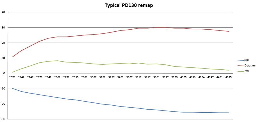

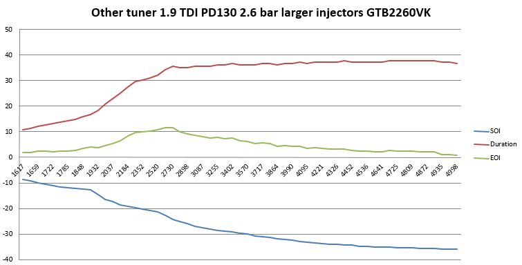

Added a couple of other graphs and setups for people to look over. All mapped by me apart from the other tuner graph.
Dont ask me who's it is as I wont tell you :)
- = BTDC
+ = ATDC
fuk the SOI on that 2nd graph is dangerous and must have smoked its absolute **** off but compensation is given as EOI is very low
28 should be the limit and 30+ if you don't mind pushing it and no fussed about engine maybe letting go
Edited by silky16v

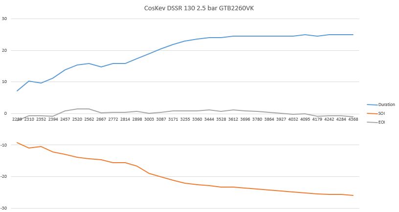

Very long duration for bigger nozzles isn't it. The duration I'm running on kevs is very close to stock pd150.
The original 215bhp limit for stock nozzles came from the theory of EOI being around 7 degrees ATDC. People said running past this will result in increased smoke and EGT. This theory I believe is wrong as you still make power past 7 degrees without EGT increases. EGT increases when your not burning the fuel.
we know now the limits of stock nozzles you can take SOI to 28 and EOI to 10-13deg safely but this is still a lot of duration & will have some level of smoke
