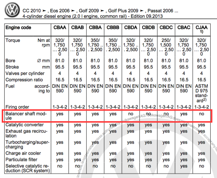

Are you saying that there is no balancer shaft module with a hex drive to the oil pump in MK2 Superb?  Or that they don't fail in the same way?
I only have the engine data from Passat B6 from last time I was in ERWIN, but it looks like to me like a few of the engine codes in Superb have balancer shaft modules, which have the hex bar delivering the final drive to the oil pump?

I think all the Superb II 2.0 CR engines have a balance shaft yes, and I would bet that most of them if not all have the revised design but I don't think anybody can say for sure. I'm only guessing from previous information I have read which also could be wrong. You would probably be safe with the facelift model.
