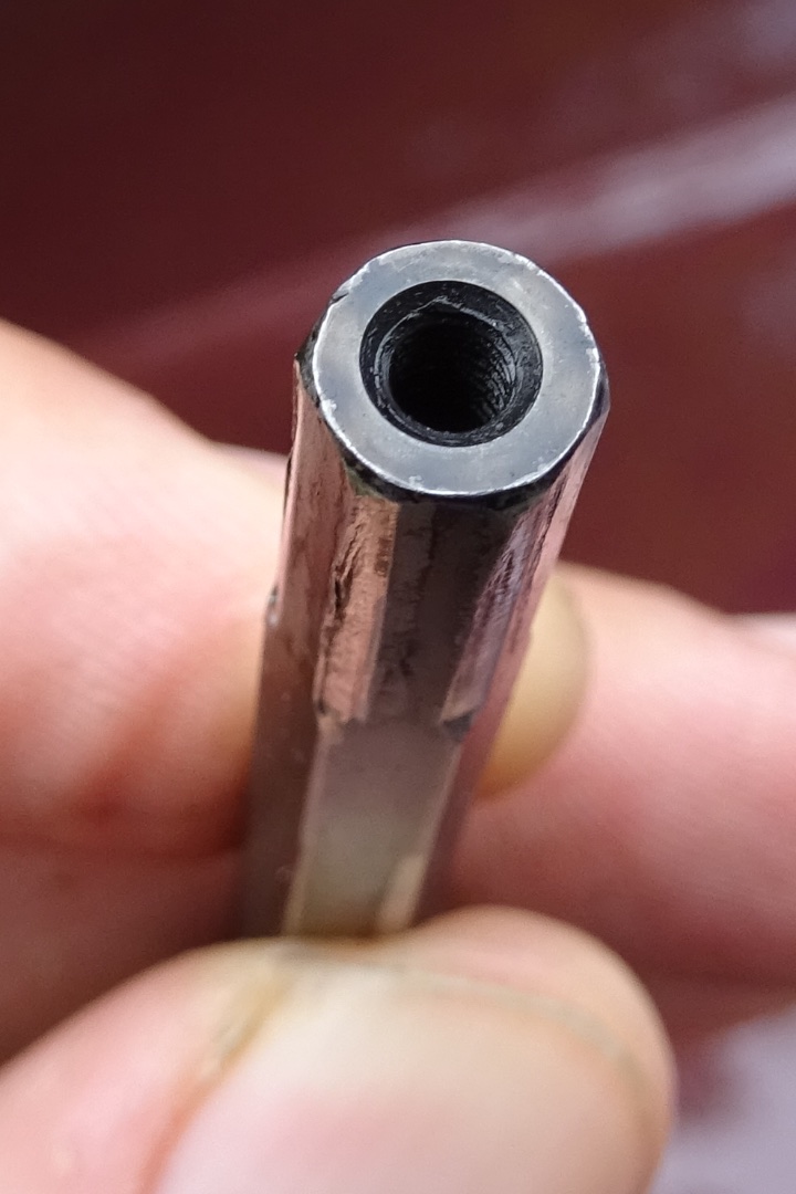

For any non-believers out there; 77mm rounded "ex"- hex drive key from my father-in-laws MK2 Superb DSG with 2.0 PD BMP engine code...

No worries.  His is otherwise a very nice car, but he got a very big bill as a result of this.  As I mentioned in another post - of course the dealer had never seen this happen before...  I'm not usually one for conspiracy theories but I'm sure there has been a fair bit of dishonesty with respect to this issue.  That photo was the part out of his motor that the dealership did at least let him have for morbid curiosity at my request.
