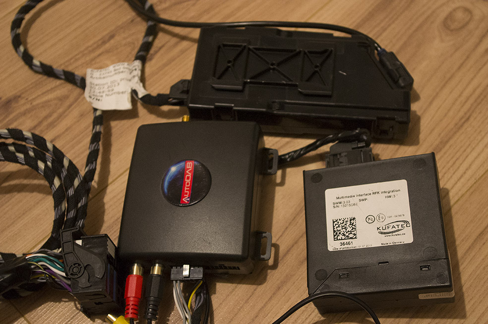

In anticipation of changing the skoda for a Golf I picked up an rns 315 and it came with a lod of Kufatec goodies. I know one is an Ipod connector but no idea what the box with DAB on is for or the other box. Anyone enlighten me? Thanks
DAB tuner?
I think it may be but not sure how that would work as surely it wouldn't be accessible via touchscreen.
Me neither, I've got no idea what Kufatec is either so I'm not much use  :sweat:
sounds like a DAB tuner. Might be accessible if the headunit is ready, just needs the add on.
The back one is clearly an MDI unit.
Edited by fabiamk2SE
I think I have found out what it all is, An MDI as already noted, a reversing camera and video input device and a dab radio add on that adds dab to none dab devices. All came with the 315 but now wondering if it will work with my columbus as I will be reselling the rns 315 due to a change of plans and sticking with skoda.
