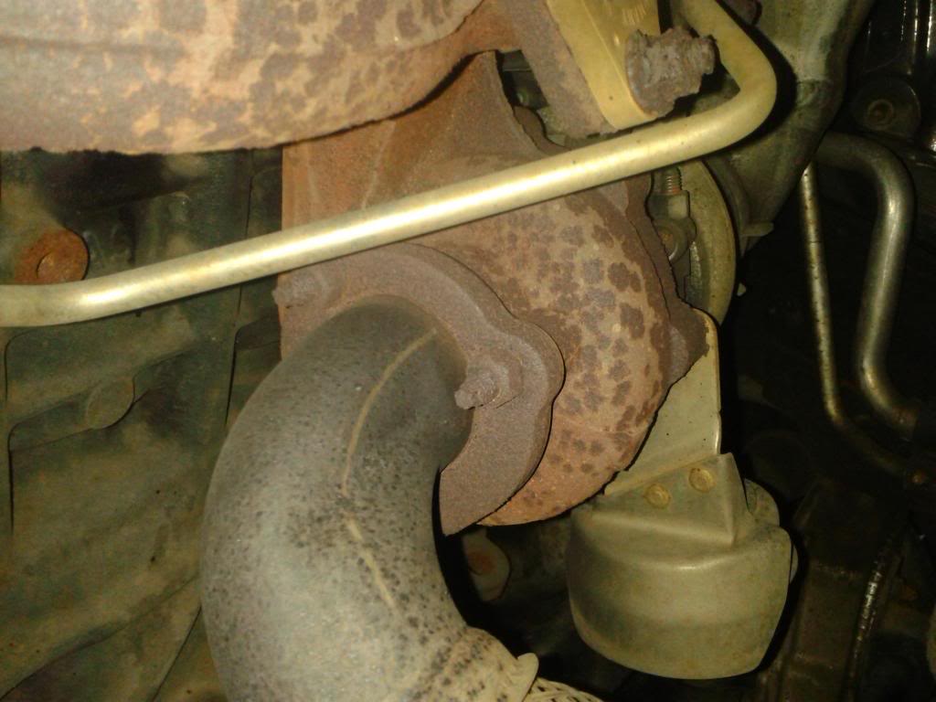

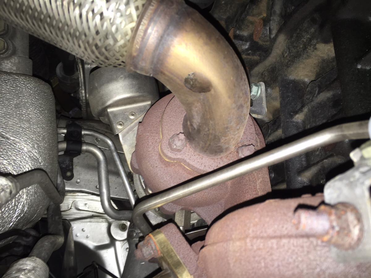

Rather than make a new thread does this look like the original turbo? It looks quite 'weathered' but compared to the turbo on my last vRS it looks pretty clean.
Current
Old

and yes, id say just looking at it, thats an original Turbo, ovbiously it could be second hand or just dirty but doesnt look like any of the bolts have been touched in a while anyway.

It doesn't look half as tatty in the pic as the turbo on my last vRS. The original will be a KKK, who makes them is it Borg Warner? I'm wondering if it's a good idea to replace the turbo as a preventive measure rather than wait till it fails as they can blow bits into the engine! Done 121k miles if it's on original so not sure how much life it'll have left. Then again it may have many more miles of life left!

If the turbo does go then intercooler will catch most of the fragments. When mine went I cleaned the intercooler out and ran the engine for a minute with the manifolds off to throw and thing out of it
