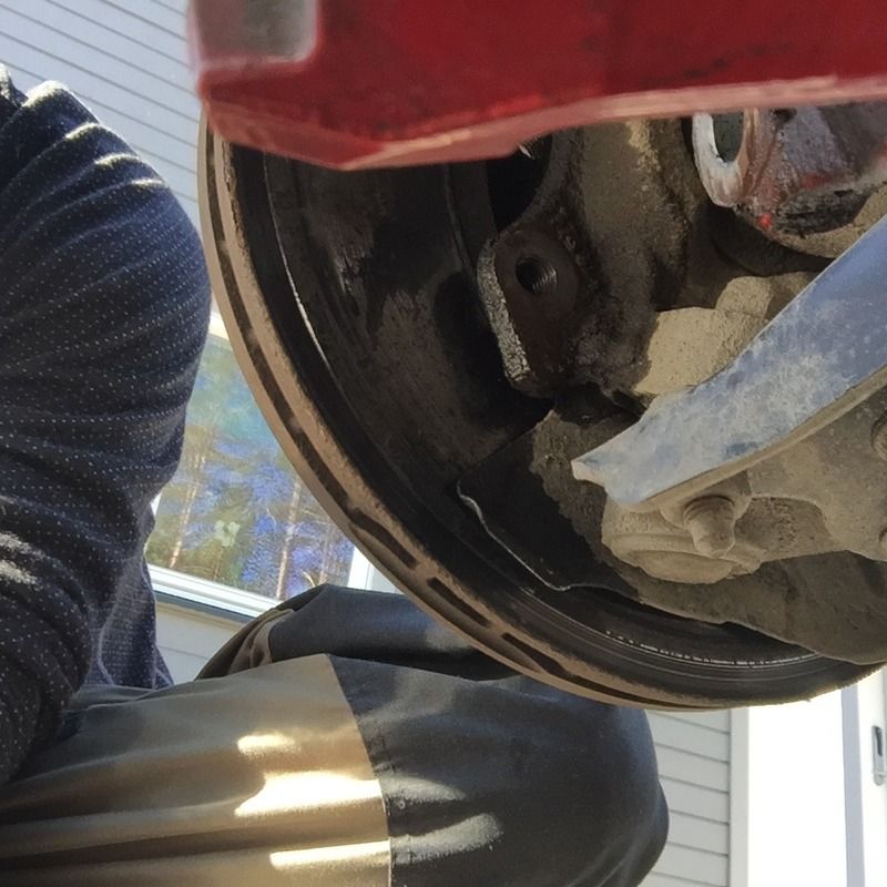

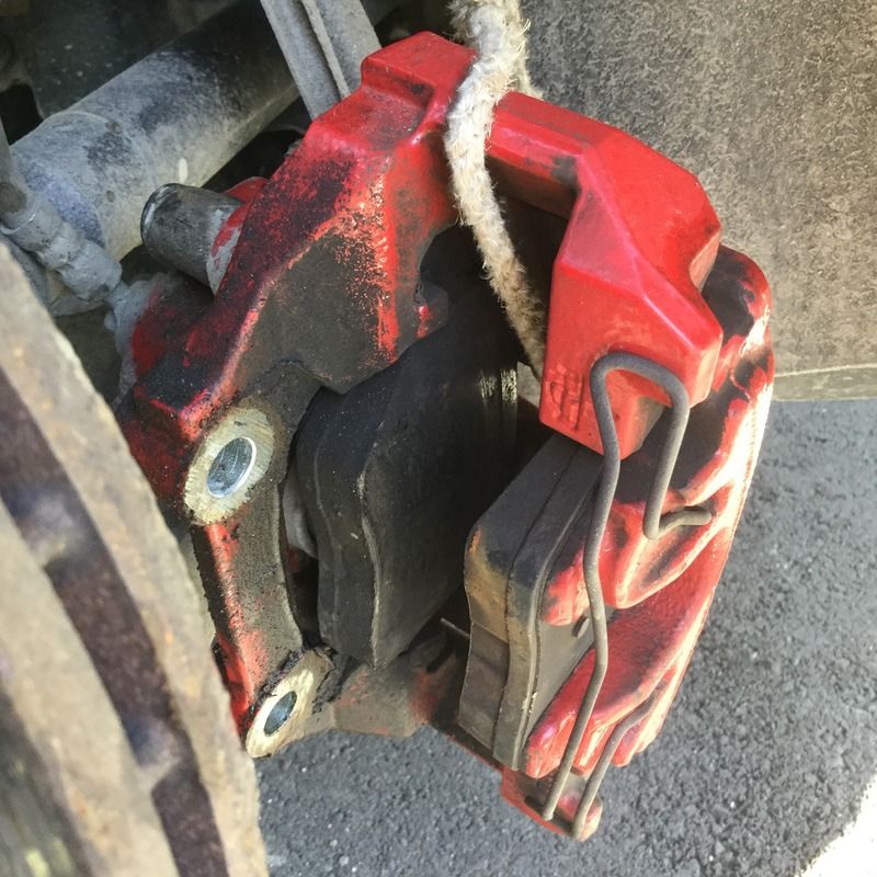

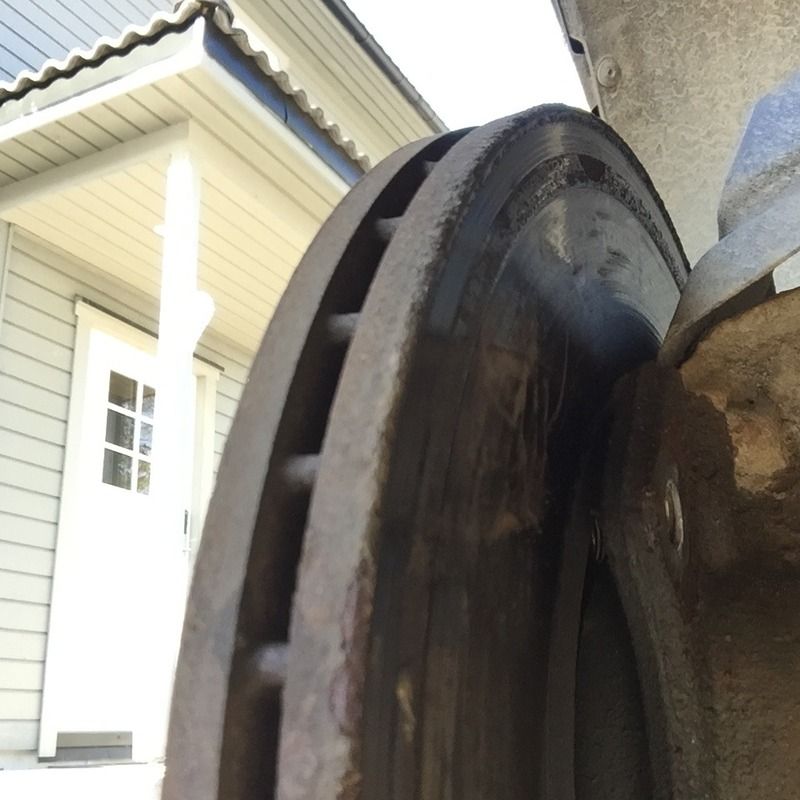

Our vRS has been giving off some grinding noises when braking lately. I visually checked the pads with the wheels off and they all looked like they have plenty of life left in them. Pinpointing the location of the sound was difficult, but it did sound a bit like it came from front right. Checked the disk and pulled the caliper today.
Just what the hell is going on here? One inverted groove about 1cm thick all along the disc, with some parts looking like larger flakes of metal has been torn off. You can see the same scoring on the brake pad.
What causes this? And more importantly, do I have to change disks and pads now?
You certainly need to replace the discs, and you might as well replace the pads.

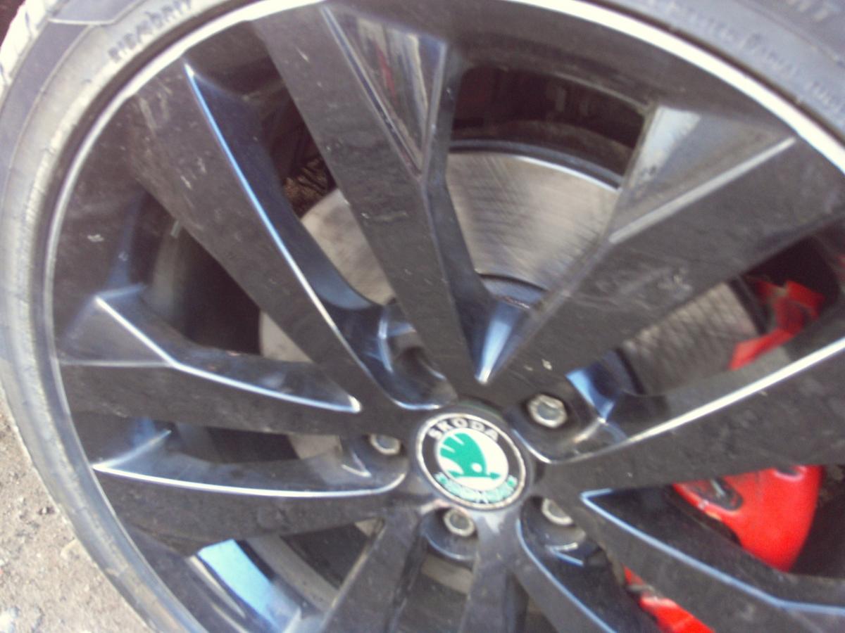

Some love and attention and cleaning up required it seems.
Sodium on the roads does tend to do that to the discs.
At 3 years old it was time for the Brake Fluid changed, so if not done worth doing now.
Edited by GoneOffSKi
Yeah it's been winter so the cleaning part had definitely suffered for a while. And in Norway there is more than enough salt on the roads, that's for sure.
All that glitters or shines is not gold. (sadly)

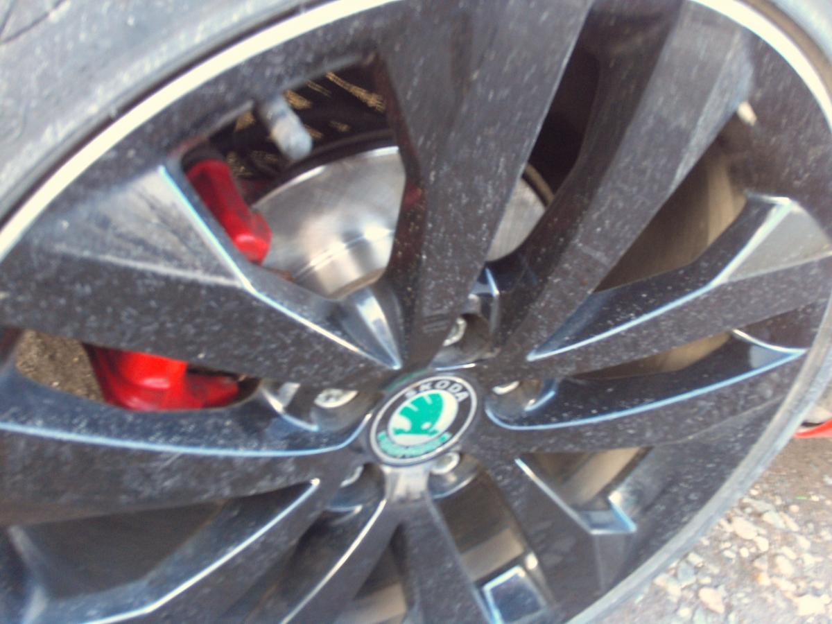

Winter salted roads take their toll.

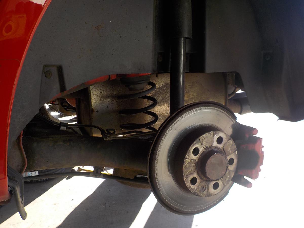

My almost 6 year old vRS is looking very tired and abused this spring, probably because it is.
The Back Box was new last year and the Discs and pads were (about 12,000 miles ago)
New springs were on last year as well.
Some care and attention & spring cleaning needed as the Dirty Wee Bisom is running great and behaving her self.
A little lube will have her looking a bit better.
*1 year ago the new discs in the last pictures went on, another set ordered for Tuesday.*

Looks like on the second picture, part of the dust shield or ball joint heat shield has been rubbing on the disc where the groove is.
When you replace the discs, I'd make sure that nothing is rubbing on them.
The thing is, the groove sticks out from the disc, not cutting into it.
The thing is the OEM. Pads outlast the OEM discs in many cases with VW brands, but I have not been much better with the ones I have fitted, 4th set of discs on the car, it comes from using the DSG more thwy the brakes to slow down. The brake pedal mostly used to clear rust off the discs.
Sorry! Hadn't noticed that. :)
