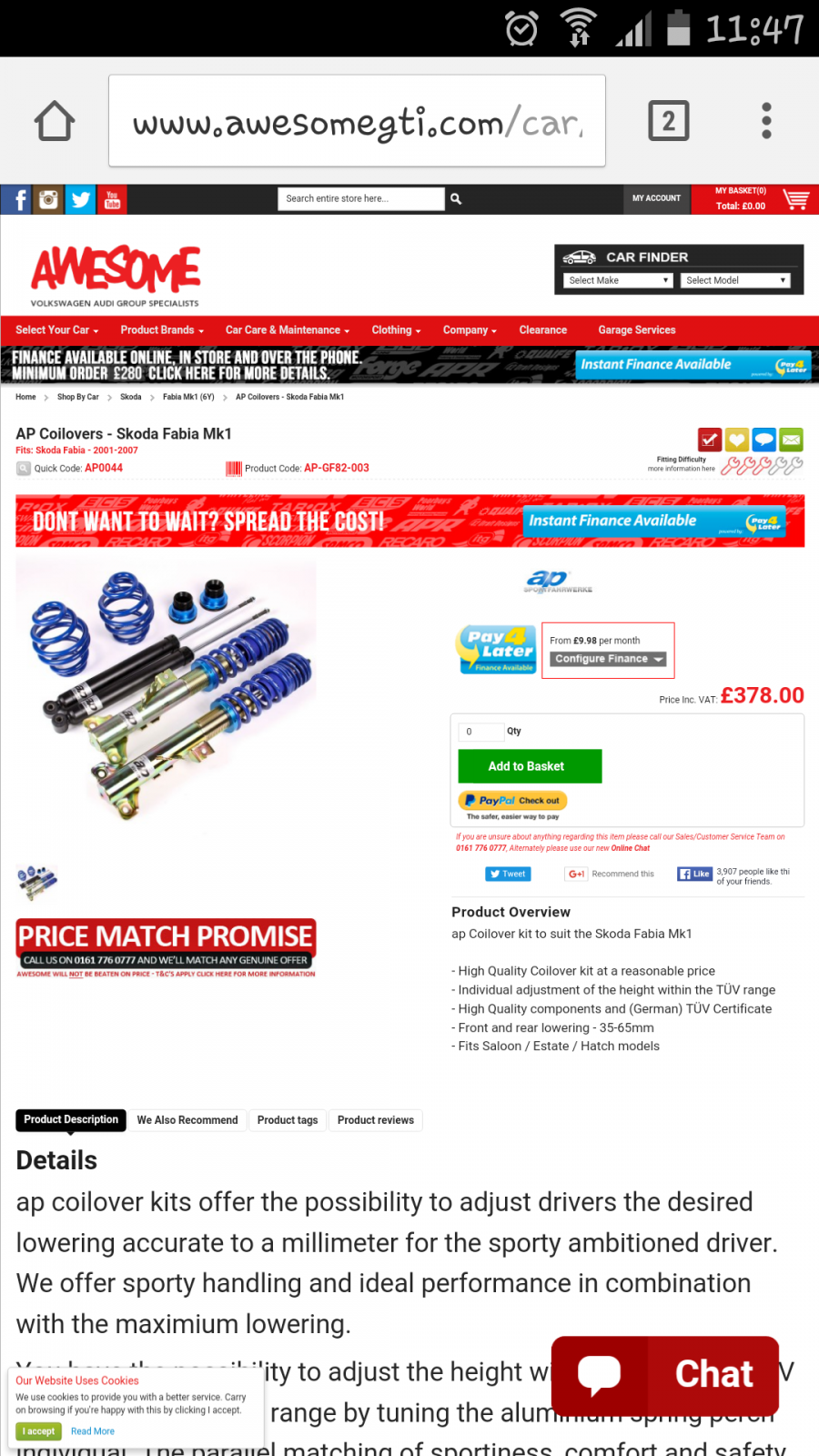

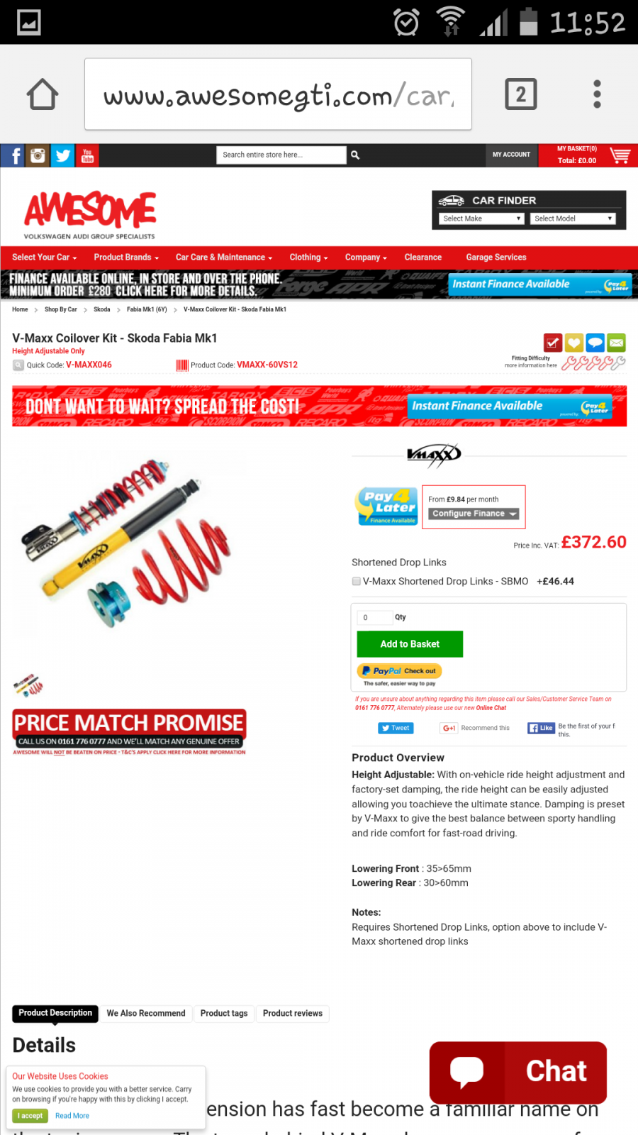

Coilovers been looking at these two what you think
Been looking at these two as I don't have the money for the kw v1 and can't fined any second hand ones anyone have experience with them
If you do a search lots of people including myself are running AP's
Are they OK for every day road use as roads round me are shot and if there not comfortable wife will kill me
I don't think any coilovers can be classed as comfortable tbh if your going from stock suspension? :)

I'd say the AP kit is the more popular option but the V-Maxx kit just edges it on comfort. A more comfortable option though would be a good quality springs and shocks kit if you can put up with a set height.

I've had thr APs fitted for about a year and am happy with them. Ride is firm but not jarring or bouncy
Cheers think I may go ap
I have had AP before, were fine aside from knocking at low speeds that was sorted by fitting some helper springs.
I'd rate the quality of vmaxx a little above AP, but the bonus of AP is being able to run standard drop links.
