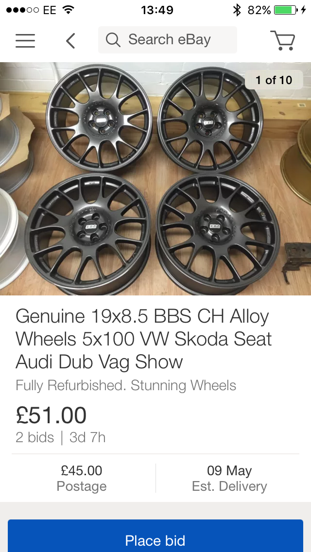

Would these fit?
Would these BBS wheels fit and what tyre size would I need to run? They are 8.5j ET 30.
Octavia VRS 2015 model at the mo with Extremes.

No, you need 5 x 112 bolt hole config/size. Smaller models use 5 x 100 like the Fabia.

BBS make that wheel 5x112 ET50 8x19 which will fit perfectly. rimstyle are stockists
