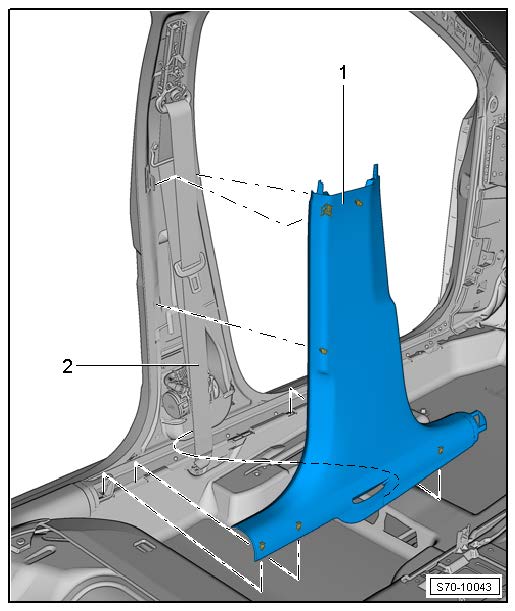

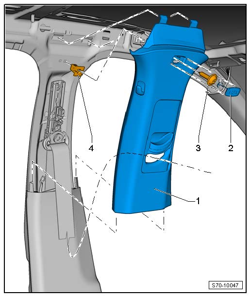

Did you try removing it?
Thanks for the pictures wlange. I haven't removed it as yet, just a good prod and push around the area to identify where it was coming from. I am certain it is this area, so if it continues I will take it off and see if I can pad it out a little to prevent the noise.
Maybe sliding a piece of thin spacer (fleece?) between the sections could help?
