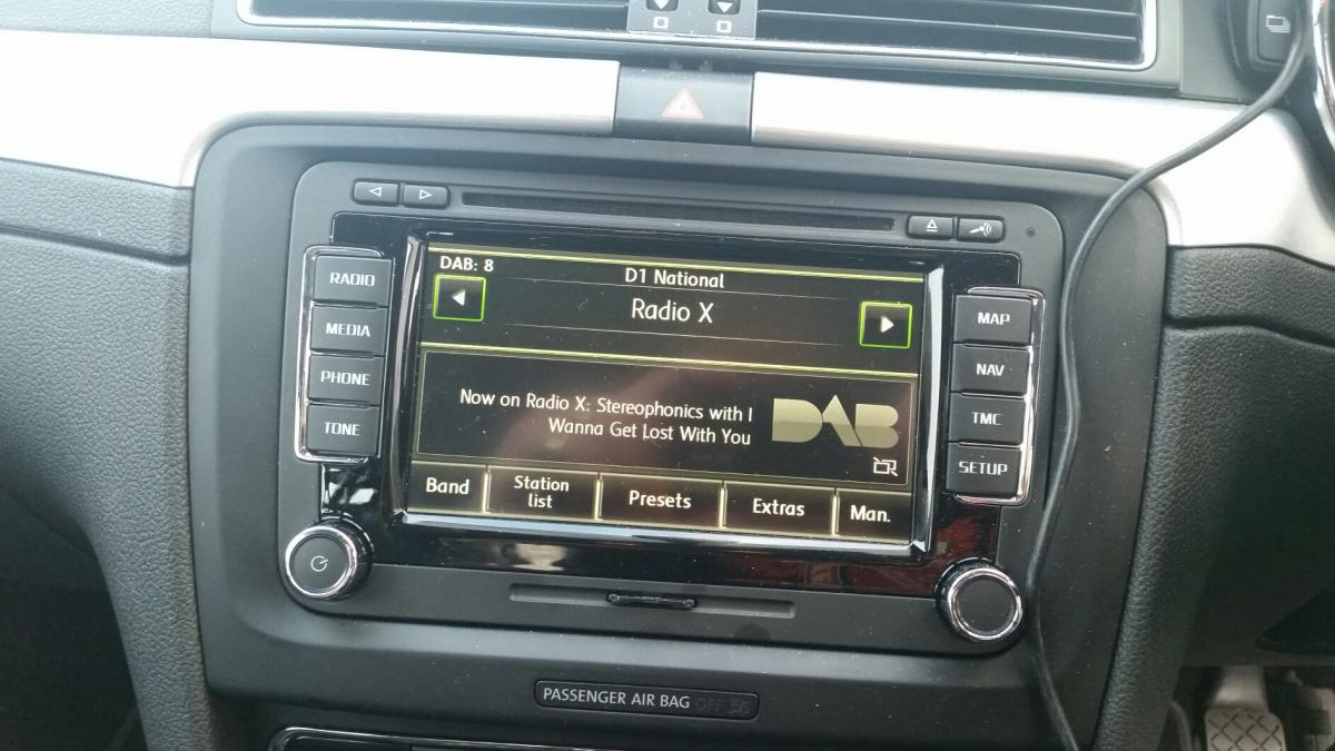

have just had a new columbus  510 unit fitted under warranty  its all working but i have just run diagnostics and get fault codes  radio not coded navigation malfunction not coded can gateway malfunction seems that skoda  have not coded new unit to car also dvd now works in motion .as its all working they say its fine but im not happy i want it done properly.also now if i disconnect battery i have to enter radio code with the old unit it was programmed automatically. any help in sorting this out would be great.  have a print out of scan will attach cheers.

Post a picture of the unit please.
Just had a look at your scan. It seems you now have a DAB unit fitted (was it a DAB before?)

Unfortunately didn't scan it before. The new unit is exactly the same as the old one dab.the dvd player packed up on the old unit. Like I say it's working fine. But obviously not been coded to car. Will attach photo
Sounds to me Rusty that its a second hand unit they have stuck in Hence the dvd in motion..thats been "Updated"....by previous owner..

Picture of unit

Well, I wasn't going to say that as first thought was a cheap chinese copy of the Columbus. But having seen the scan and the picture, I reckon it's second hand
Also, the fact that the battery disconnection means the unit asks for a code would give me cause for concern...
