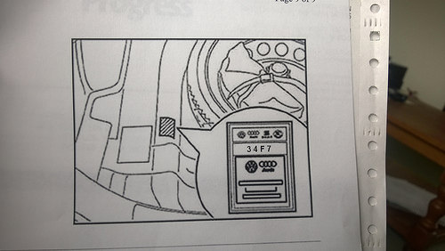

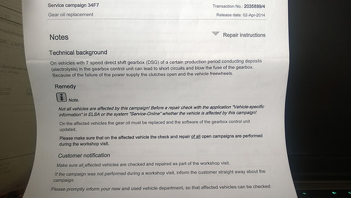

At #5.
Maybe read the 34F7 Service Campaign latest procedure as it was updated,
it does say use an external power source.
Sadly missed by some Master Techs doing the Service Campaign.
Pictures and posts taken from the DQ200 Service Campaign thread, of which there are several.

An external power source means a battery stabiliser which is to be used in conjunction with the battery, in situ.
Here's a extraction from the TPI
"Requirements for the reprogramming:
The closed-circuit voltage of the vehicle must be at least 12.5 V during the reprogramming. Connect the battery of the vehicle to an external power supply. For further information see the Maintenance manual“.
During the reprogramming switch off all unnecessary consumers (ventilation, seat heater, inside light.
Make sure that during the reprogramming of control units no electro-magnetic radiation source (mobile or cordless phone) is operated directly or around the vehicle.
After the reprogramming of the gearbox control unit the basic settings / calibration on the Mechatronics must be carried out. After the basic settings / basic calibration an adaptation drive is necessary."
