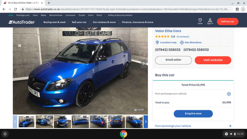

Slight thread revival, did you end up buying this car? Just spotted it for sale and looks in good order.
Looks good.
Check if the DSG needed and got service campaign '34H5', (some 2013/15 needed this.)
any ECU Software updates and any Warranty work, Oil Consumption Test or anything else.
CTHE can be better than CAVE, but some still have issues.
You want the Brake Fluid to have been changed on 2016 and again since.
The Spark Plugs at least once, the air filter etc etc.
But just look at the service history, but more important the Warranty History from 2013-2016, and has it still got the original engine.
Not that a replacement is a bad thing.
What are all 4 tyres like, the discs, the windscreen, etc etc.
Nice if it has 4 Rainsport 3 with good tread.
*Someone fitted 215/40 R 17*  Standard/OEM  is 205/40R 17.  Good upgrade the 215 IMO.
Look at the spare, look under it. Is the spare tyre well dry.
Car looks good though.
