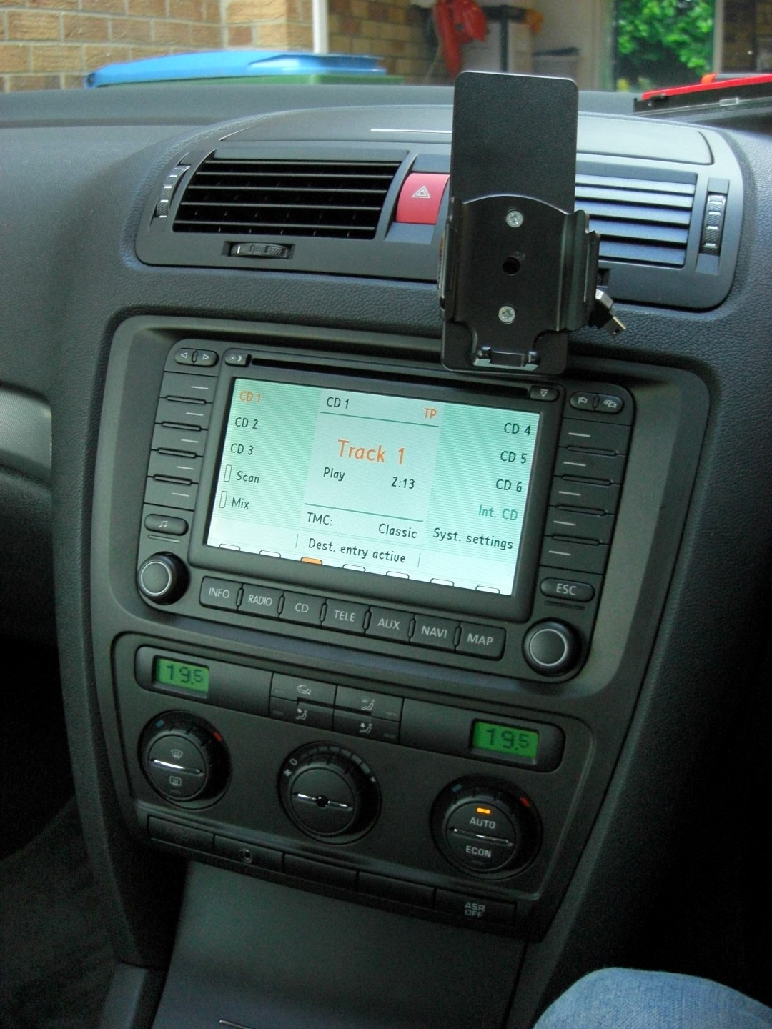

Might be good to find out what's currently fitted before spending any money, anything written on the unit or can you add a picture?
I think some VAG radios do LW but to get there you need to select AM then keep pressing down on the frequency selector until you end up in the LW spectrum.
If its the factory unit from 2005, it will be the MFD2/Nexus
Really, this one doesn't...sadly.
That's the one. I have one in mine, I'll double check later if it goes into the LW band.
Thank you!
OK here's a pic.  Looks like the one pictured above.

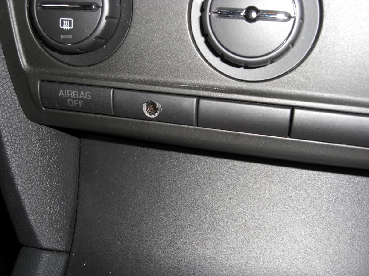

2 very dull questions:
How easy is it to add an outboard 3.5mm socket?
Do I need different connectors?

Are you sure you don't already have an aux in socket in the armrest?

I doubt it Phil, the AUX socket wasn't fitted until the steam-mp3 came about as standard, which was ~ 2008.
That said, the MFD2 does support aux in, so it's just a case of buying the cable and plugging it in.
https://www.kufatec.de/shop/en/car-hifi-components/aux-terminal-adapter/aux-in-jack-3.5mm-adapter-vw-mfd2-rns2[/quote

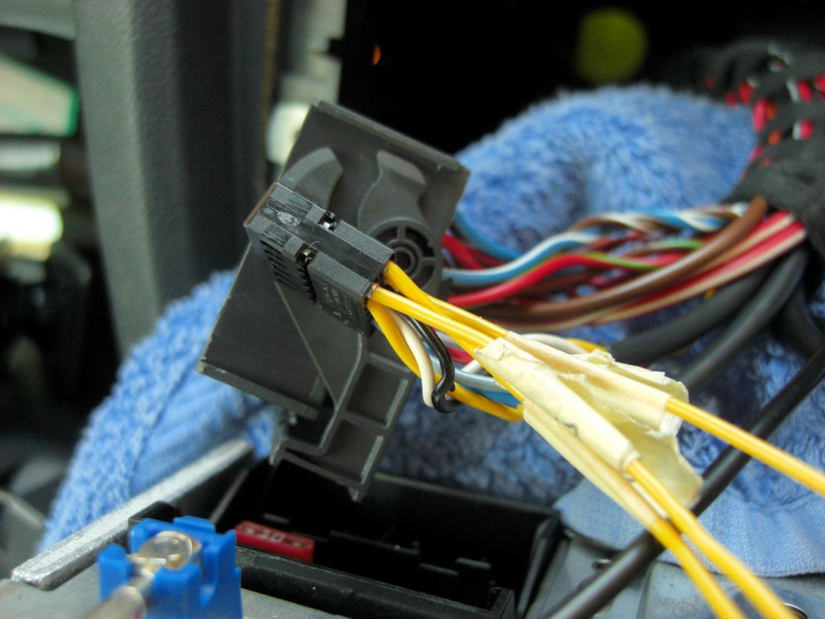

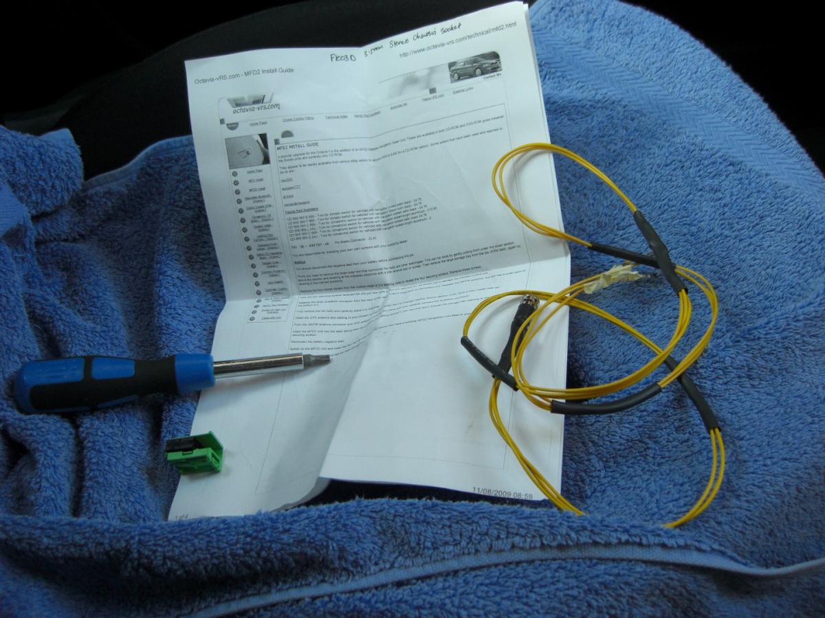

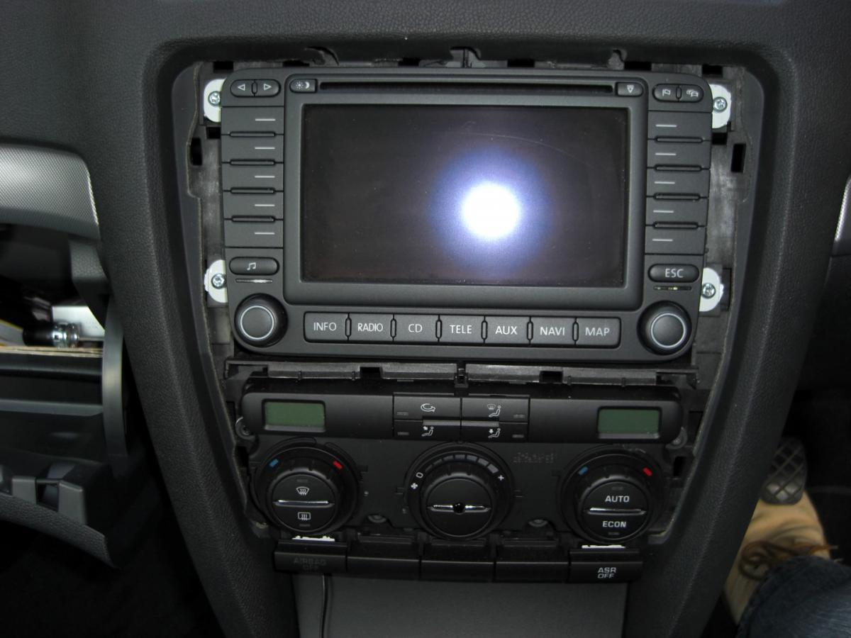

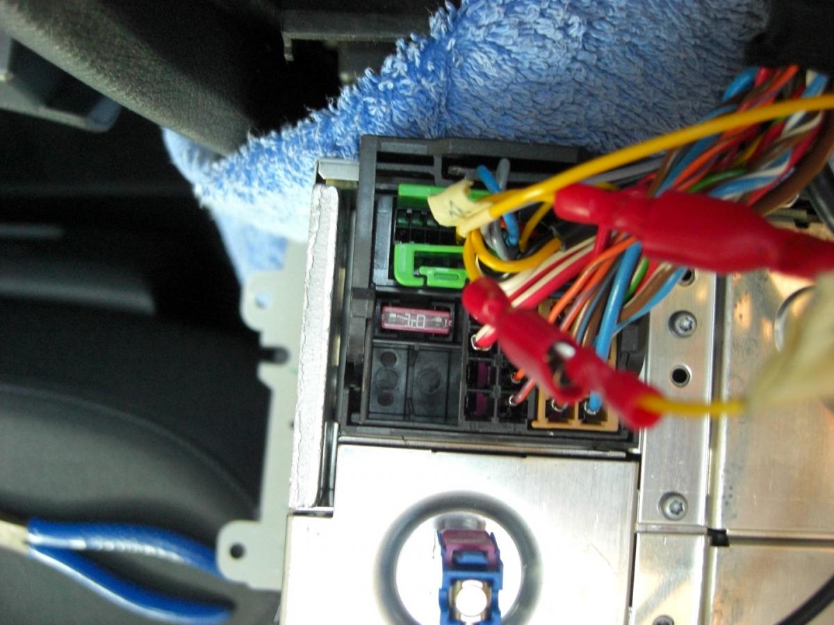

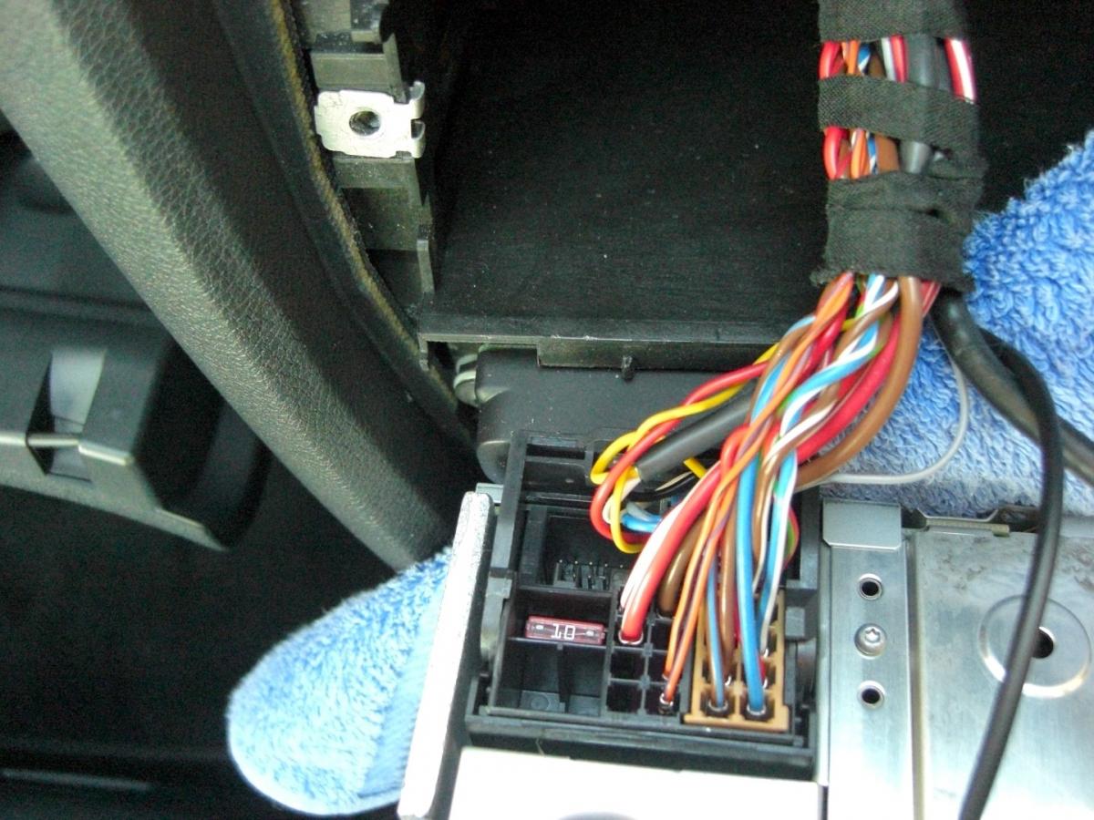

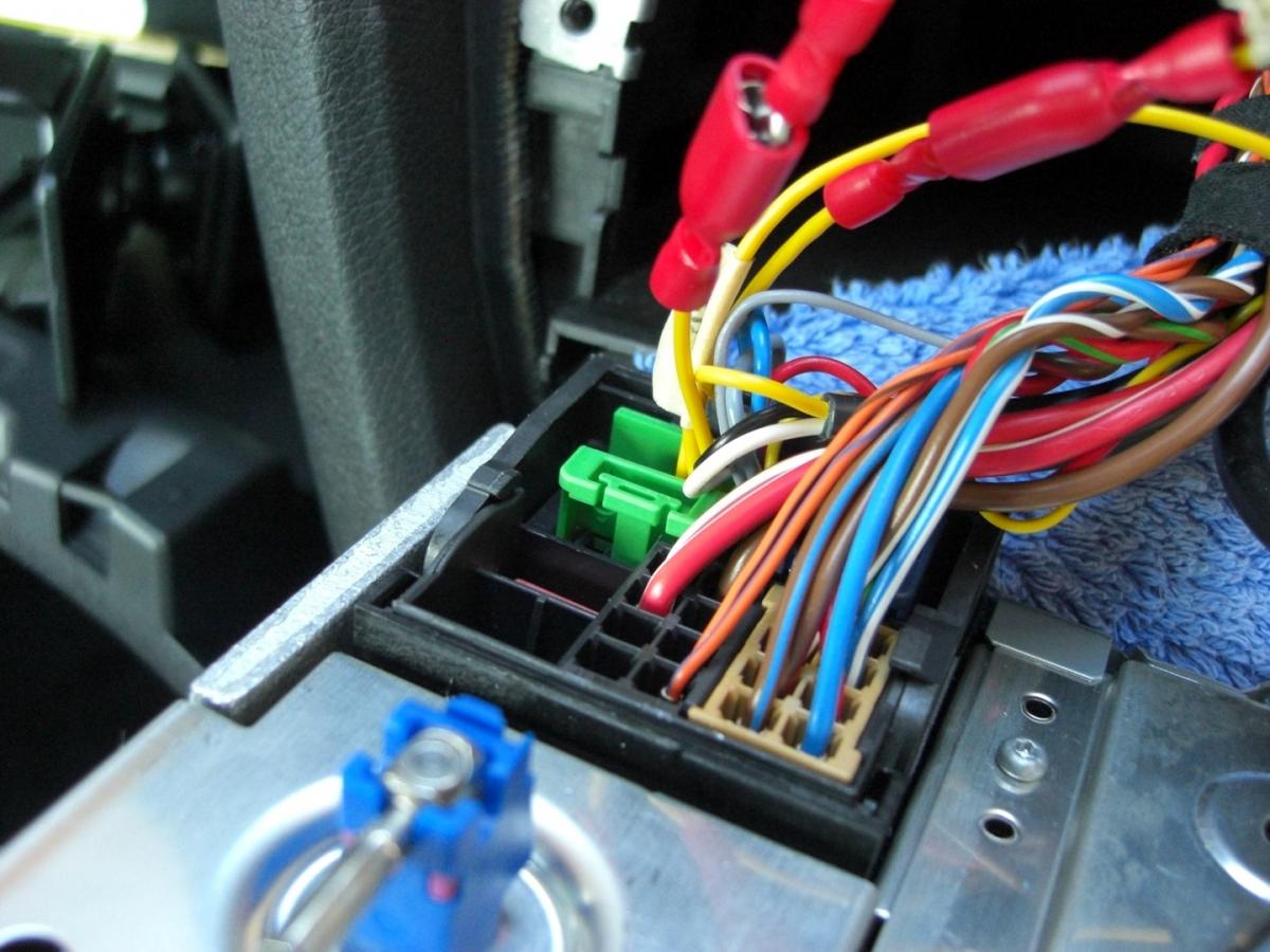

I fitted an Aux-In to my MFD2 in my PD140. It wasn't that difficult. You needed two repair wires from VW/Skoda and a 3.5mm socket.
Not that complicated to do if you're handing with a few basic tools
