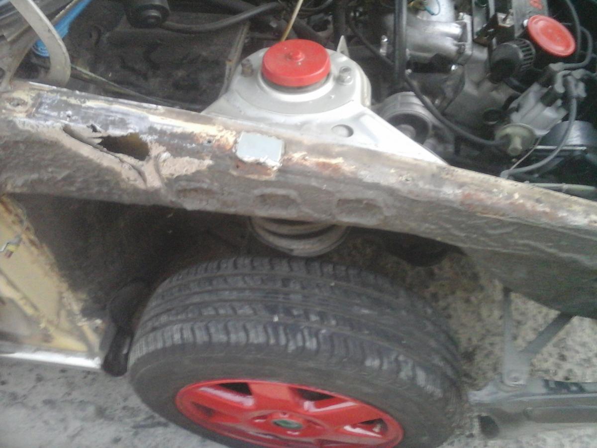

felicia rusty on inner wings
hi there, i have some rust problems on the inner front wings, i need to remove the front wings because i cant clean the rust easily with it in place. now the problem is its sealed on and i dont know where is should cut the sealer because its all covered in undercoating. anybody have some pictures of the inner wing and possibly could arrow points on the picture of where should i be cutting the sealer ?
thanks
I have used a chisle and a hammer to remove wings take you time and your get it off hole with no damage it's tiger seal that holds then on...
hammer tiger hole then chisle on it's off take you time...
Thanks for the replies. Im assuming that its sealed behind the indicator and im the wheel well. Is it also sealed where the wing bolts to the frame ?
Success ;) thanks guys did exactly what you suggested :)

i managed to get rid of all the rust, grind all of it and cut out the rusted areas and patch with fiberglass sheets and fibre filler over them, primed everything and undercoated everything
