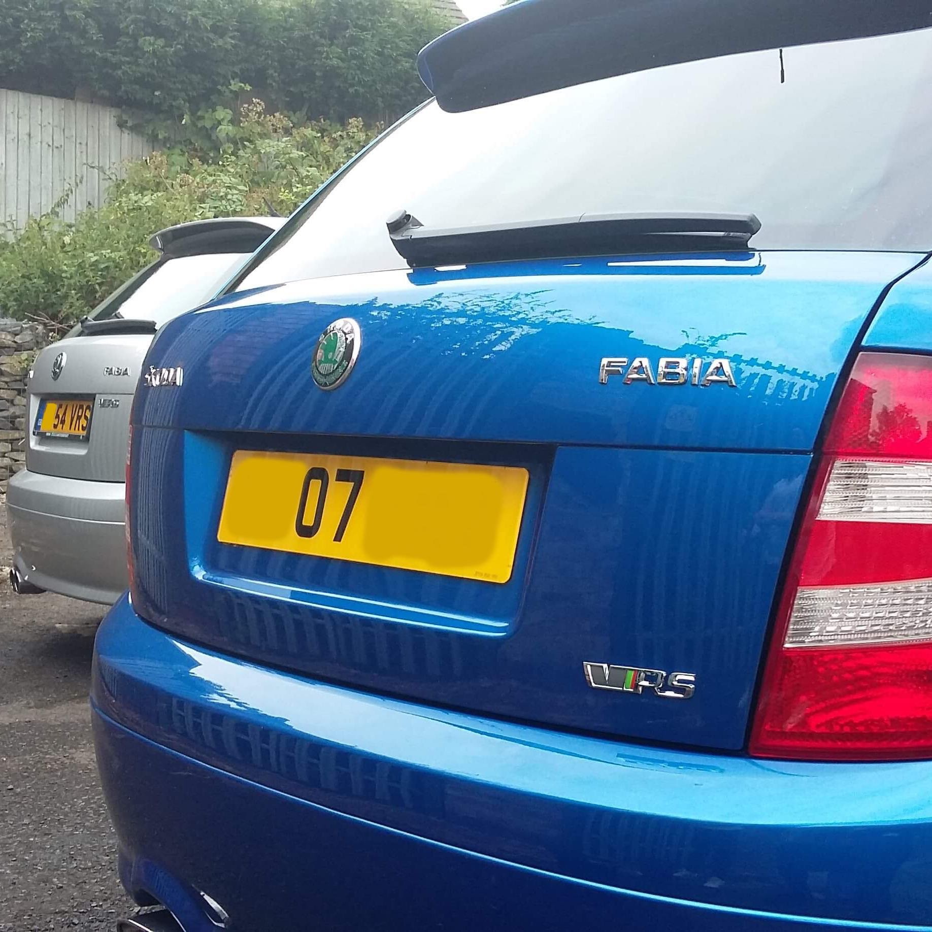

Rear badges were changed to more ‘modern’ ones…

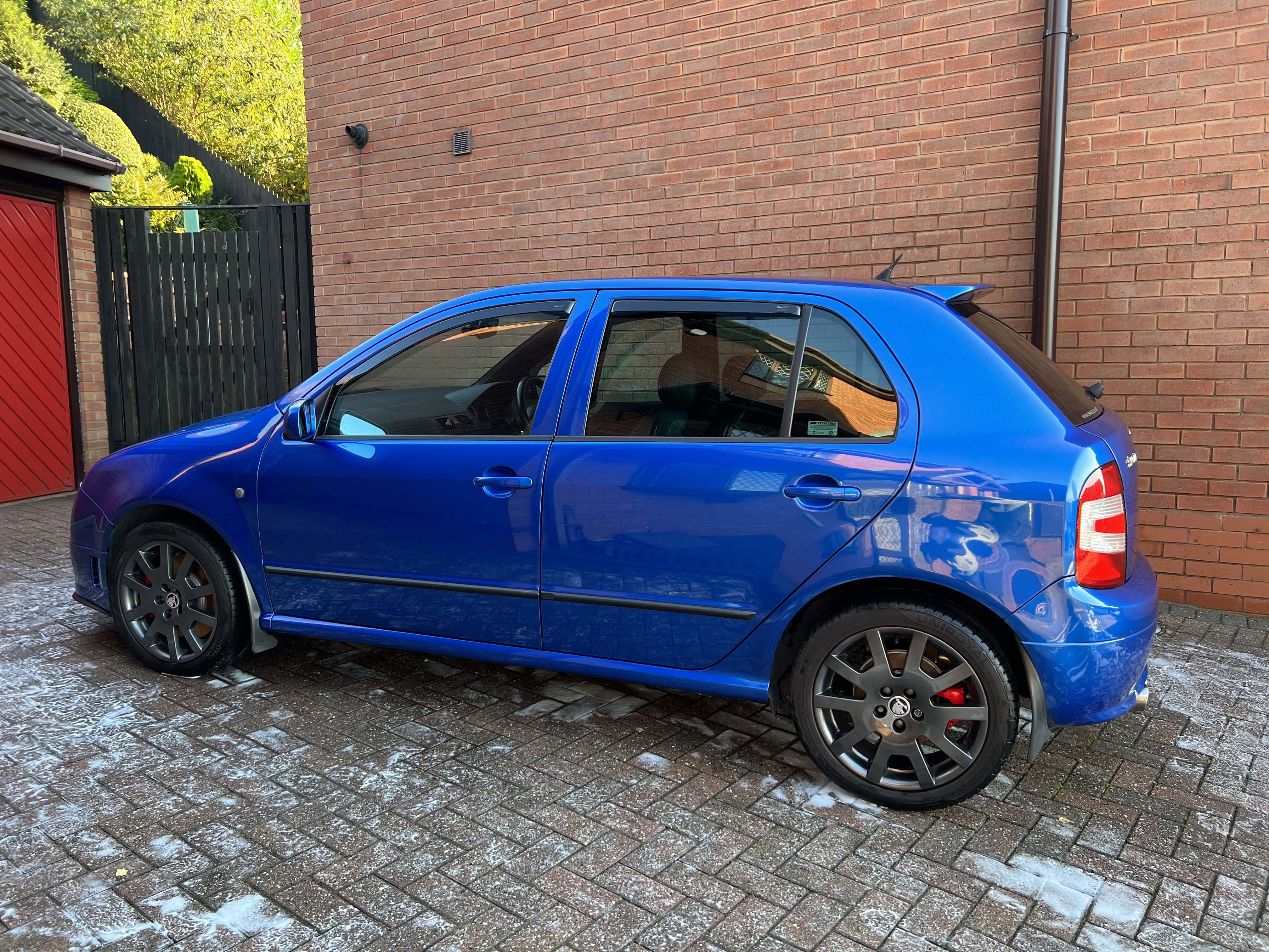

Wheels refurbed in a dark grey/anthracite and new wheel badges.

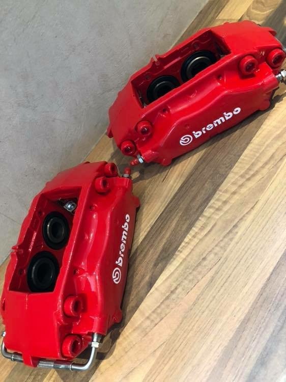

Yeah, i’ve used them before for my old rear brakes and the Brembo’s i’ve got.

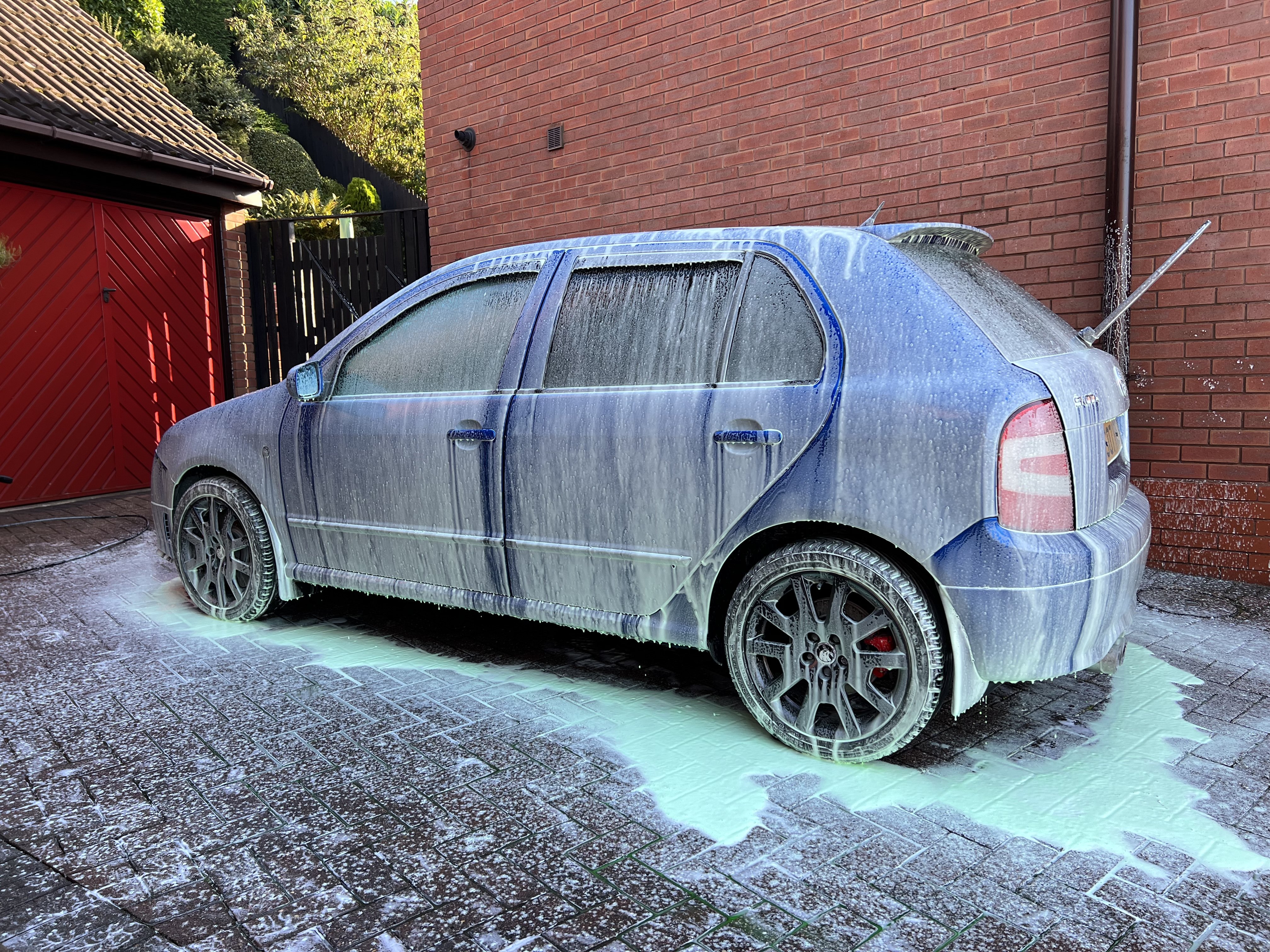

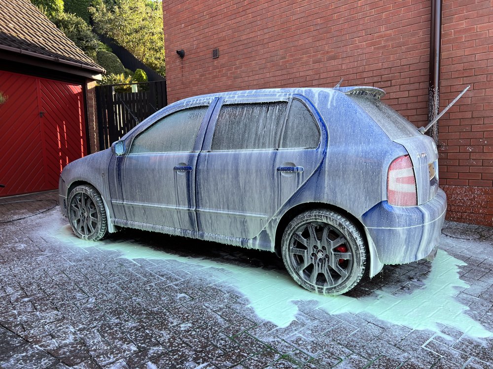

Also gave the SE a clean and ceramic coating today…
Edited by SE20TD
Tidy. Very nice 😍
