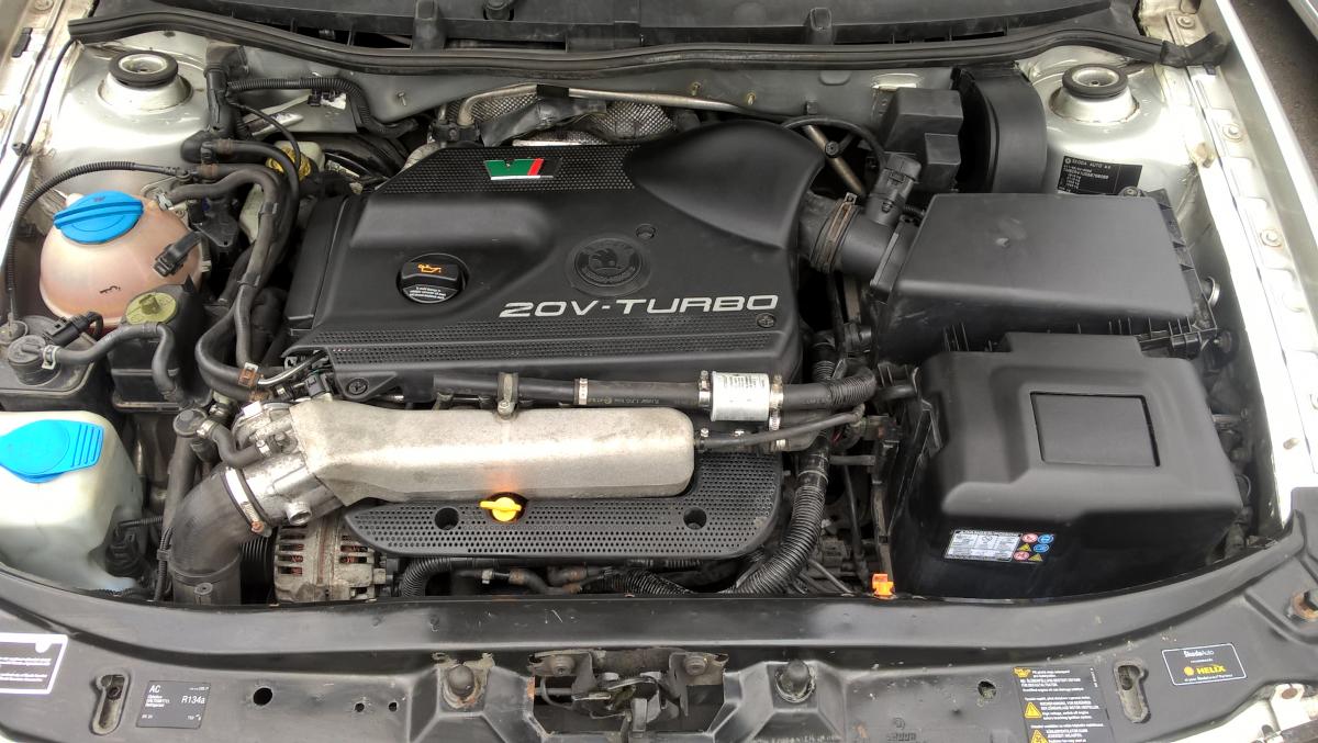

Hello,
Recently bought a octavia RS 1.8t 2002 and i dont know how everything is supposed to look.
Is this how the correct air-intake to the airbox should look?
http://assets.suredone.com/1517/media-pics/cp023474-431021250.jpg
Is that the only part? it just takes air from behind the headlight?

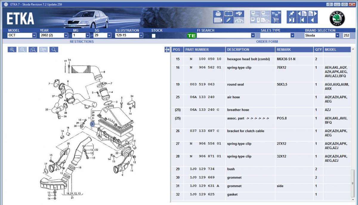

Your part is item 9
Edited by Silver Bullet
Any use?
Yes great help, but i still dont se all, is there a pipe going in under the fender aswell?

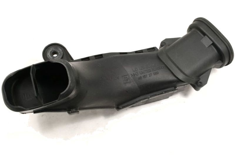

A closer Picture of the pipe would be great

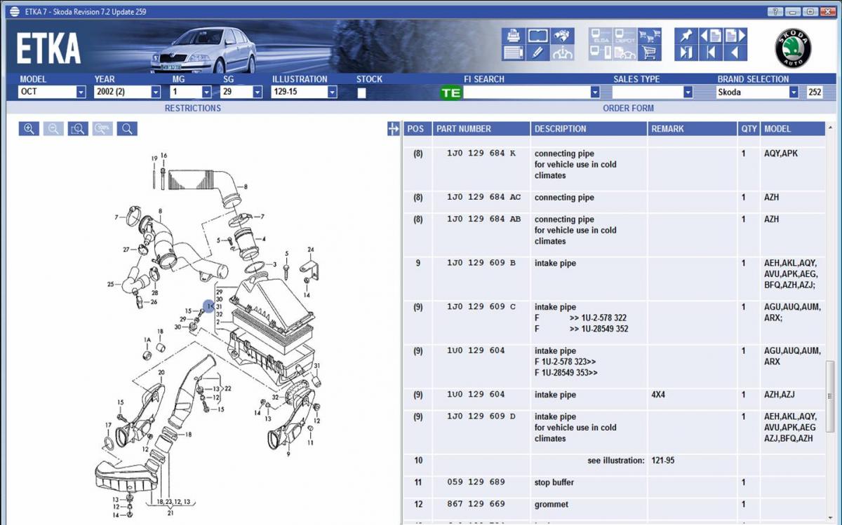

Your part is item 9
To se the rest of the part numbers would be great. I wounder what number 21 is
There you go , but it looks like a few parts have been discontinued or replaced as you can see number 21 is not listed.

Yes i found and bought that pipe Outofthi5world had pictures of
