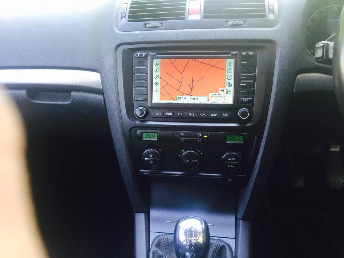

I have an Octavia 2006 Elegance 1.9TDI with a factory fitted MFD2 sat nav/cd/radio system which works on (outdated) maps but off cd which takes forever to load up.

First off, my steering wheel does not have any controls, but the sat-nav does come up on my dash. I do not have (or need) a rear camera but do have sensors which bleep.

I am uploading a photo of my dash incase it helps.
