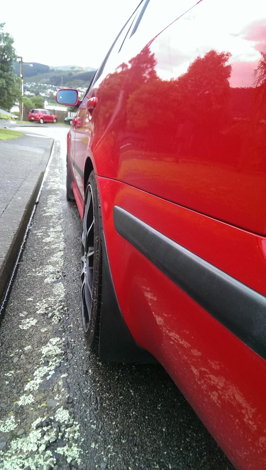

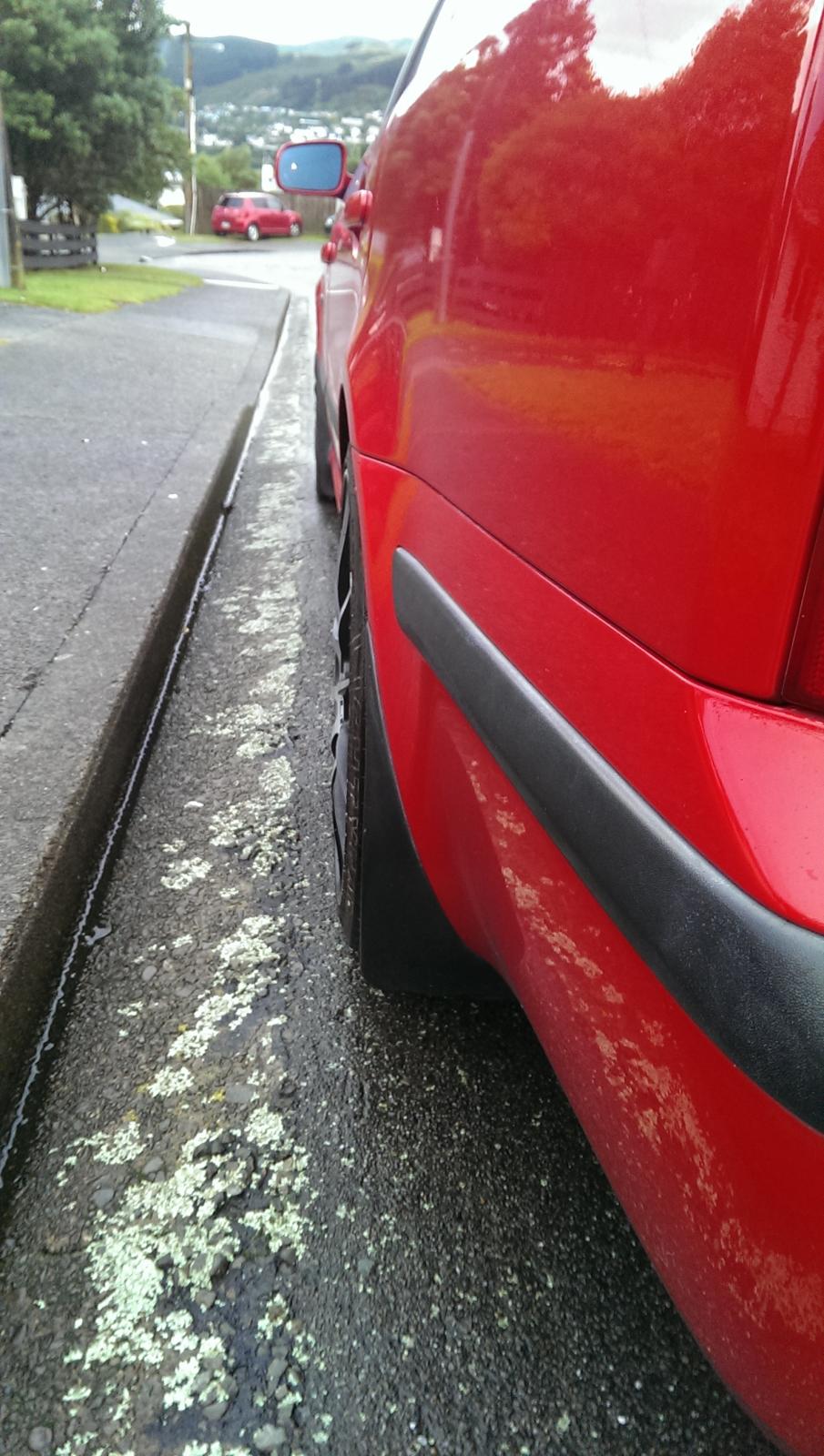

Snapped a quick couple of pics this morning. Not sure if they'll help at all.post-2744-0-65795600-1467244068_thumb.jpgpost-2744-0-86370200-1467244061_thumb.jpg
Thanks, can see they definately tuck in quite well there, and thats a 215 40 right? Im guessing the stretch on a 35 would be an even more angled curve? Thanks for all the help btw. I appreciate it

Yep 215/40 Hankook Evo V12
