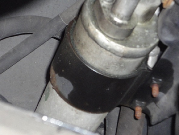

additionally...
i have taken a look at a drier, and it seams as it has a leak or this is nothing ...??
does anyone knows in what state drier should be?
and again...if this is some kind of a leak, would this explain the problem from my first post?
and if, can it be fixed somehow or new one should be installed?

to recap...
i had changed the receiver drier (it was leaking after all) 30€ and regas and it is now stone cold. Very happy.
now when it has a pressure the electric fan is working on high speed as well
