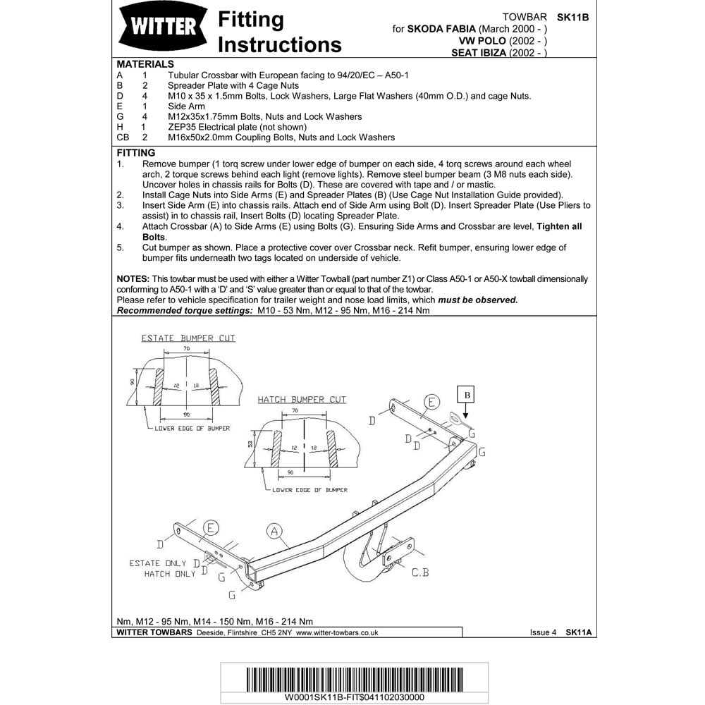

Have a 2006 fabia VRS and want to fit a tow bar without cutting the rear bumper up.
Also being a fabricator welder, I'm going to make my own but need something to work from.
Does anyone have a dimensional drawing that will sit under the car and come up and around the rear bumper that I can work from to make my own?

I had a tow bar on my vRS combi and only had to trim a very small amount out of the bottom of the bumper. I can't imagine the hatch being much different.
Might be a little helpful
Brilliant will use then and modify to suit if need be, will just dimension it up when I finally have a spare moment :)
Will post the drawing when I have finished.
