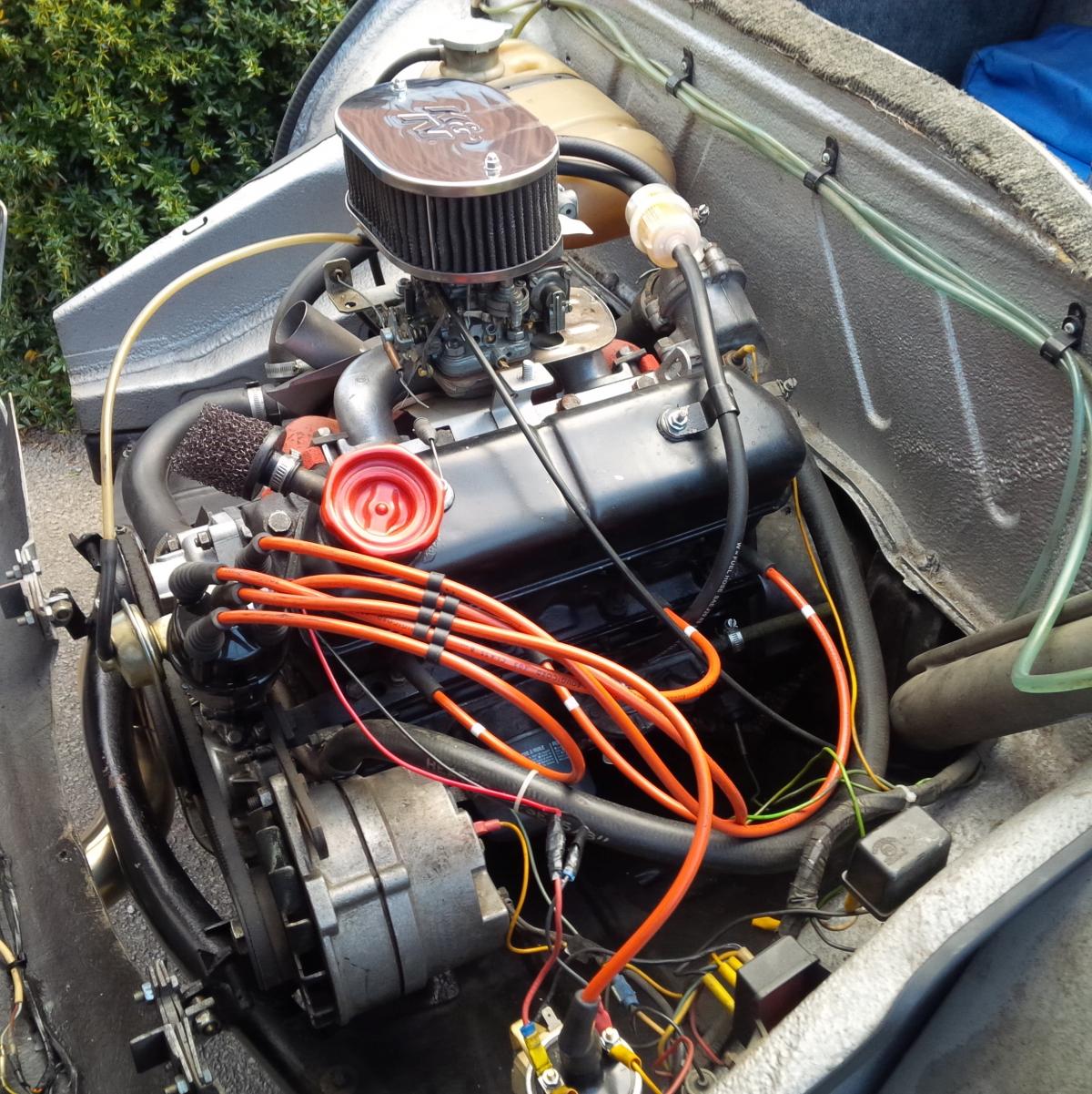

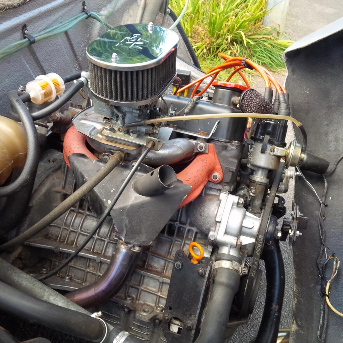

Done so far, in the pursuit of a better standing start, as the top speed is good.
Fitted and tuned replacement Weber 30dic carb
Running k&N filter
Electronic iginition
Free flow performance exhaust
What else could i do, within reason and viability??
Different camshaft?
