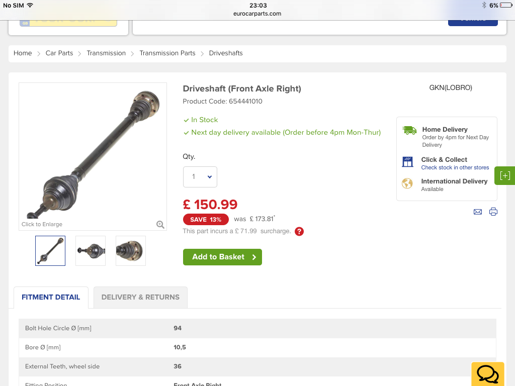

BMN is the wrong one, you should I think have selected the one below.

I popped in the reg.and it was a non stock item,so they ordered me it over the phone.
That look's more like it.
GREAT!  :x

There is a notification at the top of the page (as there normally is) that even though you have put your reg in there are multiple fitments available. So then you have to read down the fitments details and by process of elimination work out which one is the right one for you car. Sometimes they list the PR code that's on your data sticker (handy) sometimes as in this case an engine code (BMN which is a 2.0 8v PD iirc).
No when i put in my reg it only came up with the one i purchased.
If you manually enter spec of car.Then it give's you option's.
