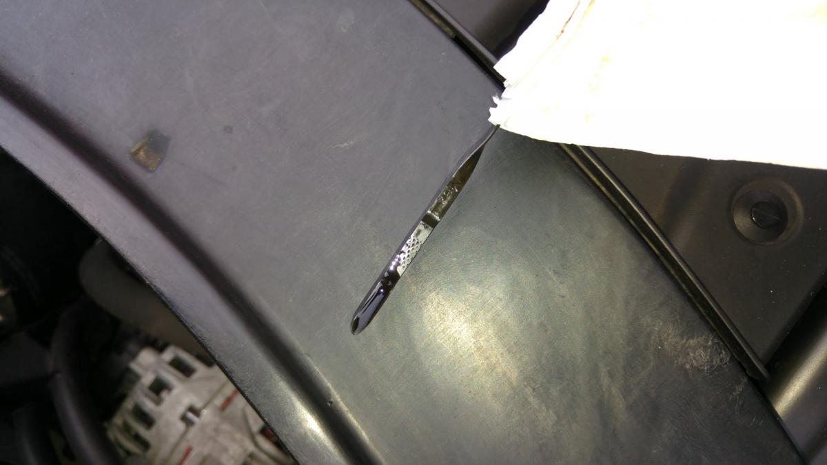

This was the car parked up on the flat road outside my house:

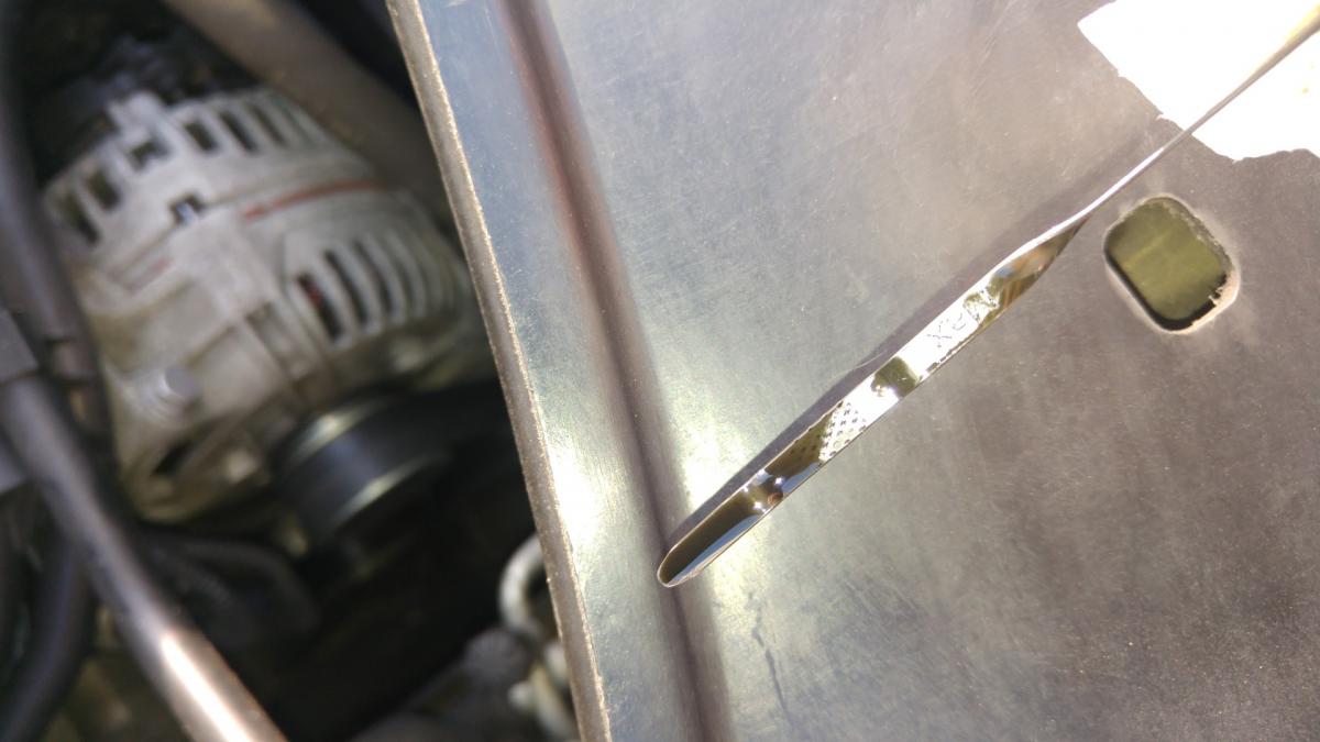

This is after around 80 miles :o in the exact same spot outside the house
Defo need to get this sorted!
Are these both 'Cold Dips',  Stone cold.
Or when still Hot, or warm?
When was your last Oil & Filter change done and did you dip the oil cold after that was done to see where the level showed?
Top was warmish and bottom was slightly cooler (maybe 20mins and 30mins respectively)
Oil and filter last done at 62,000miles by a Skoda Dealer. 5w30.
