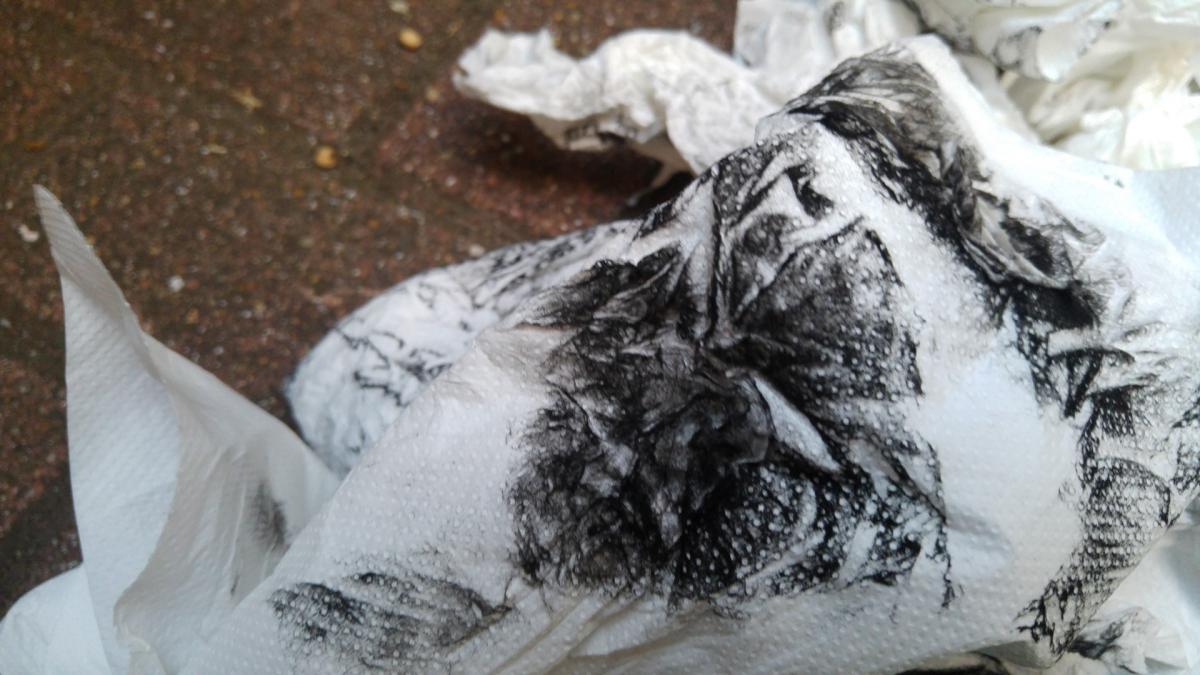

Cars gone in today for the oil consumption test.

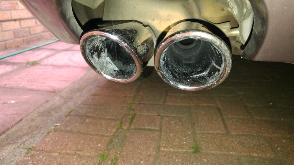

As part of it I've tided up the exhaust pipes from all the soot that is there. Is how they looked:

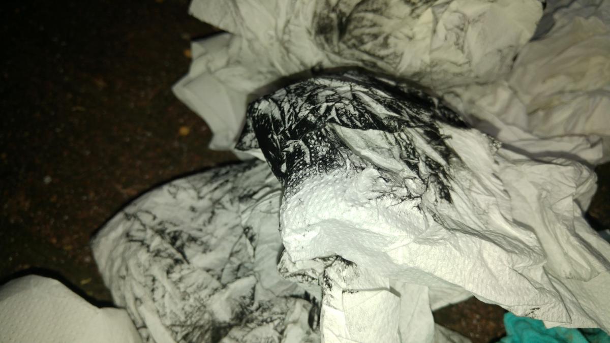

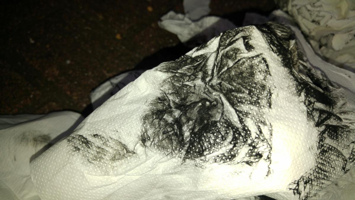

This is what came out of the pipes when wiped inside:

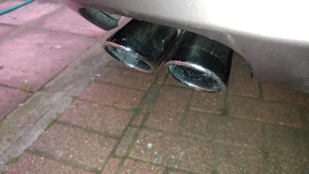

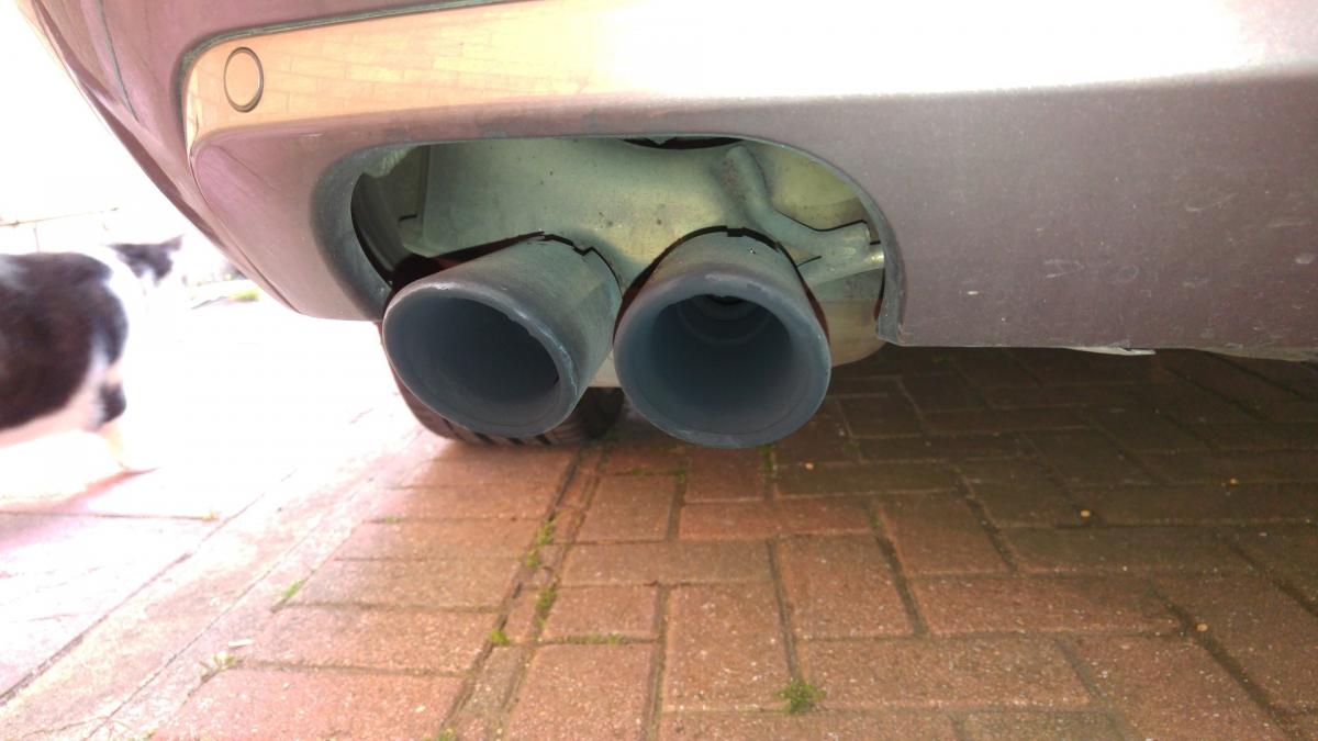

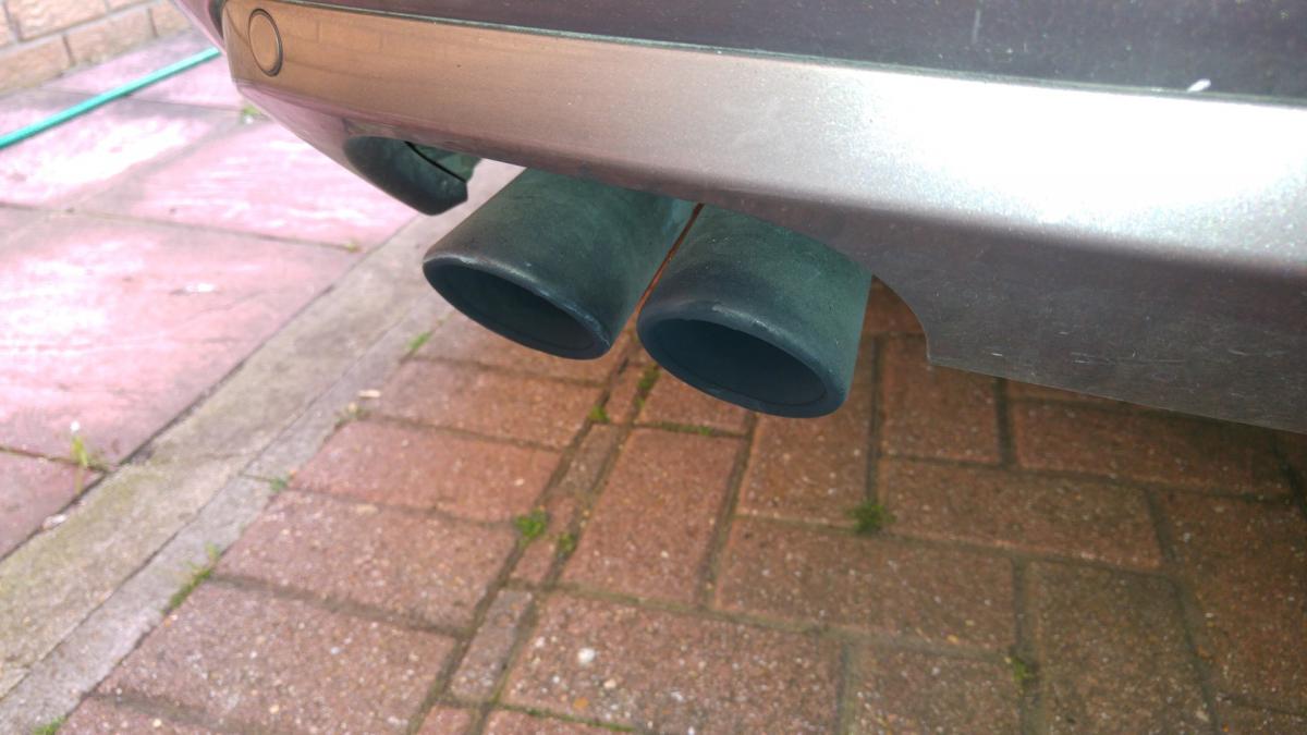

Cleaned with brake cleaner and autosol:
Should now be able to see how much soot is being produced as can photo to compare.
I did notice several large clouds of sooty smoke (like a 00's TDI!) at times. Probably where all the oil is going!
With the 1.4 TSI Twinchargers soot has nothing to do with the Oil Users.
The soot comes from the way they run rich when cold and the engine is not up to an efficient temperature,
then when you boot one you often clear out the sooty build up in the exhaust system.
The Update Software Skoda apply or a REmap often can change that.
I see plenty oil users in Twinchargers with no sooty exhausts, the oil is burnt up at the Cat, and some cars getting new engines needed
new cats, but Skoda UK was often loath to pay to replace them.
Which was odd as they were paying out £4,000 or so and the CAT was scrap as they knew damn well.
