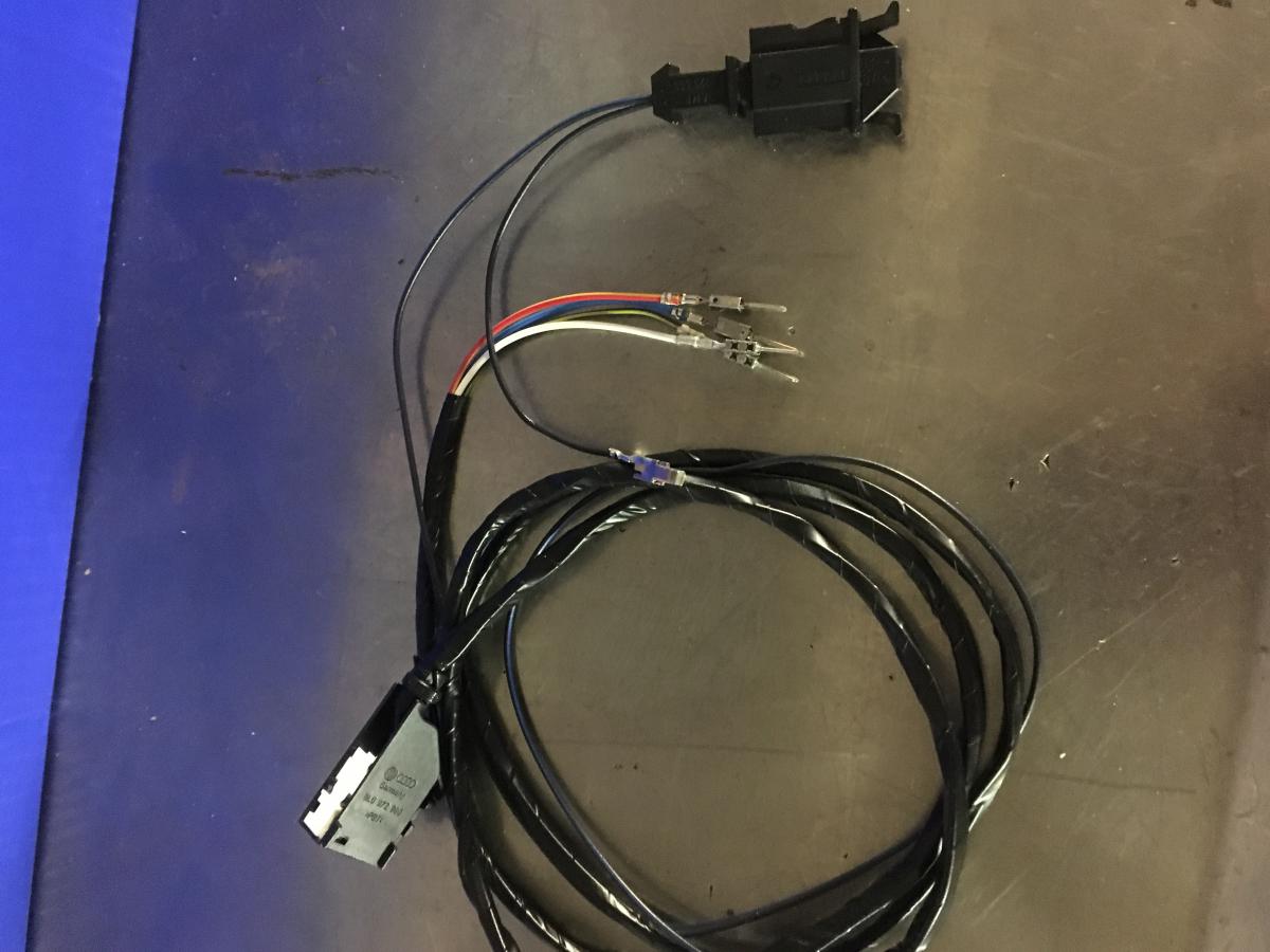

Oh if show you the colours would people know.

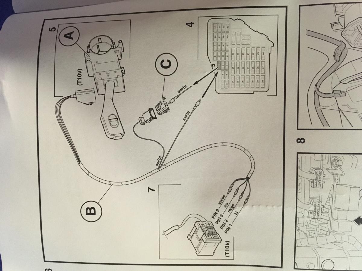

Probably just work best going PIN number on the stalk to the PIN numbers in the bulkhead plug. I'll see if I can find my current flow diagram.
One is a big pin and other two are small one has two wires and other is a bare cable. Don't have a clue where each go so if you do that would be great.
Black/Yellow to pin 3
White to pin 9
Blue to pin 1
Red/Yellow to pin 2
Black/Blue to ignition ON supply
All connected. Just need to connect to vag come now.

I'll upload these just in case someone searches for this thread later on.
All activated and working :)
